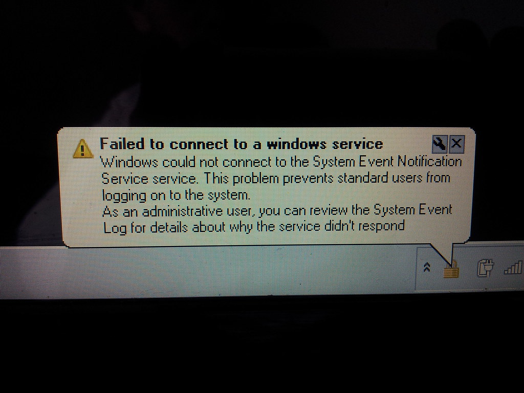

windows 7. update problem by scilly puffin, on Flickr

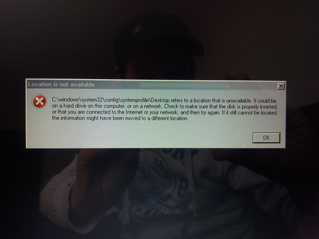

All seems ok at the moment, does anyone know what went wrong with the above? I am thinking maybe they are corrupted files causing the problems?
