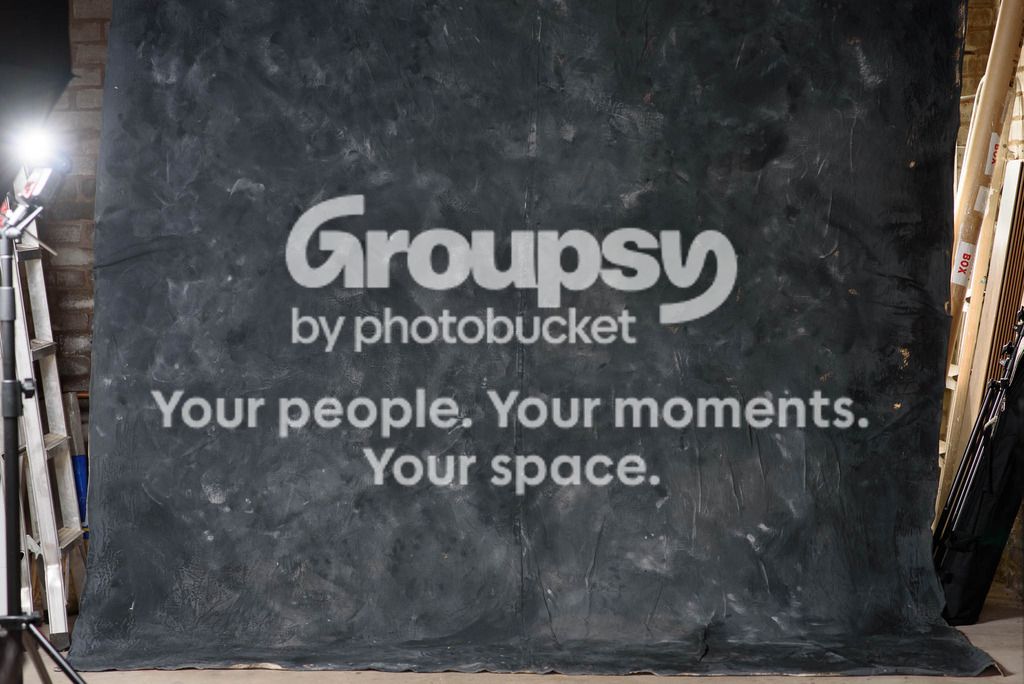

here it is...
Ok I take back the mean things I said about Sarah Oliphant their stuff is clearly a mile away in quality and look but lets be realistic for a minute. It doesn't look that bad imo and it was made in under 4 hours start to finish for under £35. I'm fairly confident MK II will go a lot better as I've Iearnt a lot from even this rushed job.
