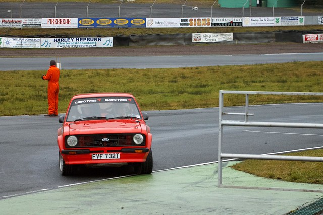

do you think i need to clean my sensor
1,237
rab
rite here is a photo settings were 1/500 /f 5.6 /113 mm / iso 3200 there seems to be more noise than i would norm see at 3200 iso or do you think i need to give my sensor a clean?

Cleaning your sensor will not reduce noise.
Take a pic of the sky at a high f stop- f16ish- to see if your sensor needs cleaning.
i will give that a bash tomorow ken i think its noise looks like i may be on the hunt for a new camera lol
No you don't need to clean your sensor,dirt on a sensor shouldn't create noise its more to do with the lighting :)
i thought it was noise but wasnt sure if it was a very dirty sensor, the light was poor and it was raining
To see if your sensor needs cleaning (BTW This isnt your problem at all) set your camera to about f32 and take a picture of a nice clear sky (or plain light clouds maybe) . view pic.. i doubt anyone will not see dirt from the sensor... but depends how much dirt :)

cheers guys yea thought it was just lots of noise a 50-500 sigma and a 1100d aint a good combo in low light lol
Ditto on noise/lighting. Suggest shot taken at highest f stop for viewing dust on sensor. Some unusual black markings on lower (concrete) part of image (down from T on reg) but doesn't look like dust on sensor. Could be something on lens. Good luck in resolving.

ISO 3200 is very high, even a top end full frame a lot of people shy away from using it. On a lower end crop sensor camera you can expect a lot of noise.
Rather than a new camera you'd be better off investing in faster lenses. f/2.8 is going to buy you 2 stops over 5.6 for example and a way better idea than relying on high ISO noise which all cameras will have.
It's the darkest part of winter - days are short and light levels much lower than you realise.
Our eyes cope reasonably well and we become accustomed but cameras struggle especially with an action type shot.

a 7d is even worse in bad light ,in fact for the conditions described and the equipment used its a brilliant shot .leave the sensor alone unless your 100% competent at doing it

Great advice above. ISO 3200 is my very top max, I try to keep it below ISO 1600, preferably as low as possible. f2.8 or f4 lenses with help to reduce the ISO value, to ISO 800 at f2.8 and ISO 1600 at f4. Don't forget depth of field reduces as you open the aperture. As you currently use a 50-500mm lens have a think what focal lengths you currently use.

You're right about the lens - faster glass will give you more opportunities, but in the interest of accuracy - ISO 3200 is nothing really on a 'top end full frame'; I've no real issue with noise up to 12,800 ISO - sure it's there, but it rarely distracts from the image, and what with the noise reduction in LR now, it's not an issue even higher.
I'd always take a noisy but sharp image over above a blurry one and to be honest I've never yet had anyone of my none - photographic friends even comment on the noise - that's pretty much the preserve of fellow photographers!
