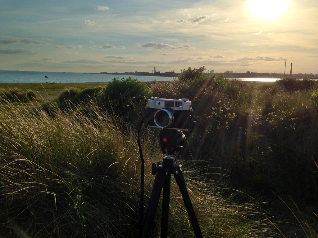

£10.40 for a Yashica J from EBay, in lovely condition. iPhone photo of it in action below (sorry about the wonky horizon), just after using the truly wonderful clockwork self timer!
Camera Roll-33 by MarkBerry1963, on Flickr
