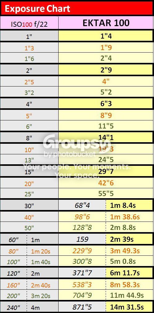

I am tonight for the first time trying some night shoots of a flood lite building, the shoot will be taken across about 100 yards of water, the building is of light coloured stone and well flood lite by up lighters. There is not much other light pollution, my problem is that I do not think that my exposure kit is man enough to give me accurate settings.
I will be using 120 ISO 100 film in both B&W and colour T-Max and Ektar, can you give me your recommendations as to speed settings with an f16 or maybe f11 aperture setting. Thank you for your help.
Richard.
