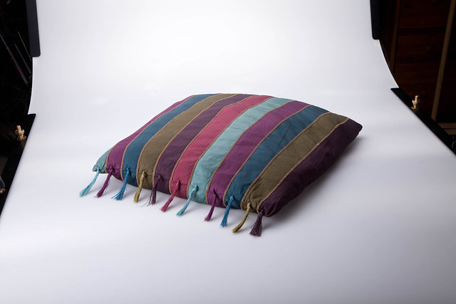

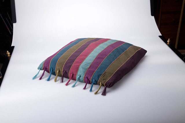

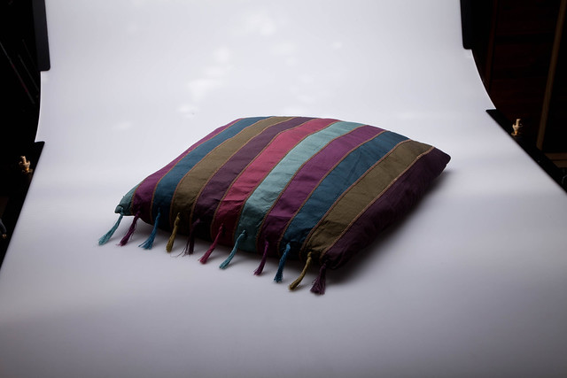

I've just realised that both of our flash units are Prolinca 500's. They both adjust with sliders and the power of the flash is adjustable from 1/1 (full) to 1/4 (lowest). I've did a small experiment to show you what I mean by flash causing severe over exposure:
I've set this one flash unit up inside of the 70cm softbox and turned it to the lowest power. the other flash unit in the corner of the room is not switched on as I just wanted to see what exposure I get with the single unit. There is some daylight in the room and I appreciate that in an ideal world I'd be hoping to use 1/125 or 1/250 on f11 or f9. However, this would be the result:
To get anywhere near normal exposure I've had to go to crazy settings at 1/500 and f29:
......... which would be no good whatsoever as the colours are completely drained and the depth is flat and horrible.
Am I right to assume that the Elinchrom 500's are just too powerful for the job, or do I just need to mount it higher towards teh 10ft. ceiling?
If I were to set up the honeycomb and beauty dish then the exposure would be even worse. I could get it as far as three metres away from the subject.

First image (overhead only)
second (overhead and from side)
Third (overhead, side and fill from white bounce)
Clearly, the third change is the most subtle, but it does kick some light back into the cushion and lift the brown end bit out of the shadows (or at least I think it does!).
To be clear, I'm not posting these as examples of how it should be done, more to show the effects of adding lights/reflectors into the mix.
Looking at that image, I see that you did indeed have the camera on manual - but you used the hotshoe flash too. That is defo not helping, you need a radio trigger.
Being able to reduce the output of the flash by just 2 stops is causing problems too. The Prolinca range of a few years ago was basically an economy Elinchrom, with less features and very limited power adjustment. Fortunately they discontinue them and replaced them with the D-Lite, which has a good range of adjustment. You wouldn't need anywhere near that 500 Ws of power even if they had a normal range of adjustment.
As Andy says, the answer is either ND gels over the lights or an ND filter over the lens, it's never perfect to use a filter on the lens because there is always some quality loss and some increase to the risk of lens flare, but in your case, using a kit lens, the image will be pretty dark when viewed through the viewfinder and the autofocus probably won't work - so, nd gels over the flash heads. They come in various strengths, I suggest 0.9 which is 3 stops. f/11 then effectively becomes f/32.
BTW, that Prolinca softbox isn't the best either, from memory it only has one layer of diffusion, it needs two. I bought one from fleabay once, threw it away as I didn't want to pass the problem onto another unsuspecting buyer:) You could improve it easily enough just by putting an additional, second layer of diffusion (plain white shower curtain is fine for this) a few inches behind the one that it has.
