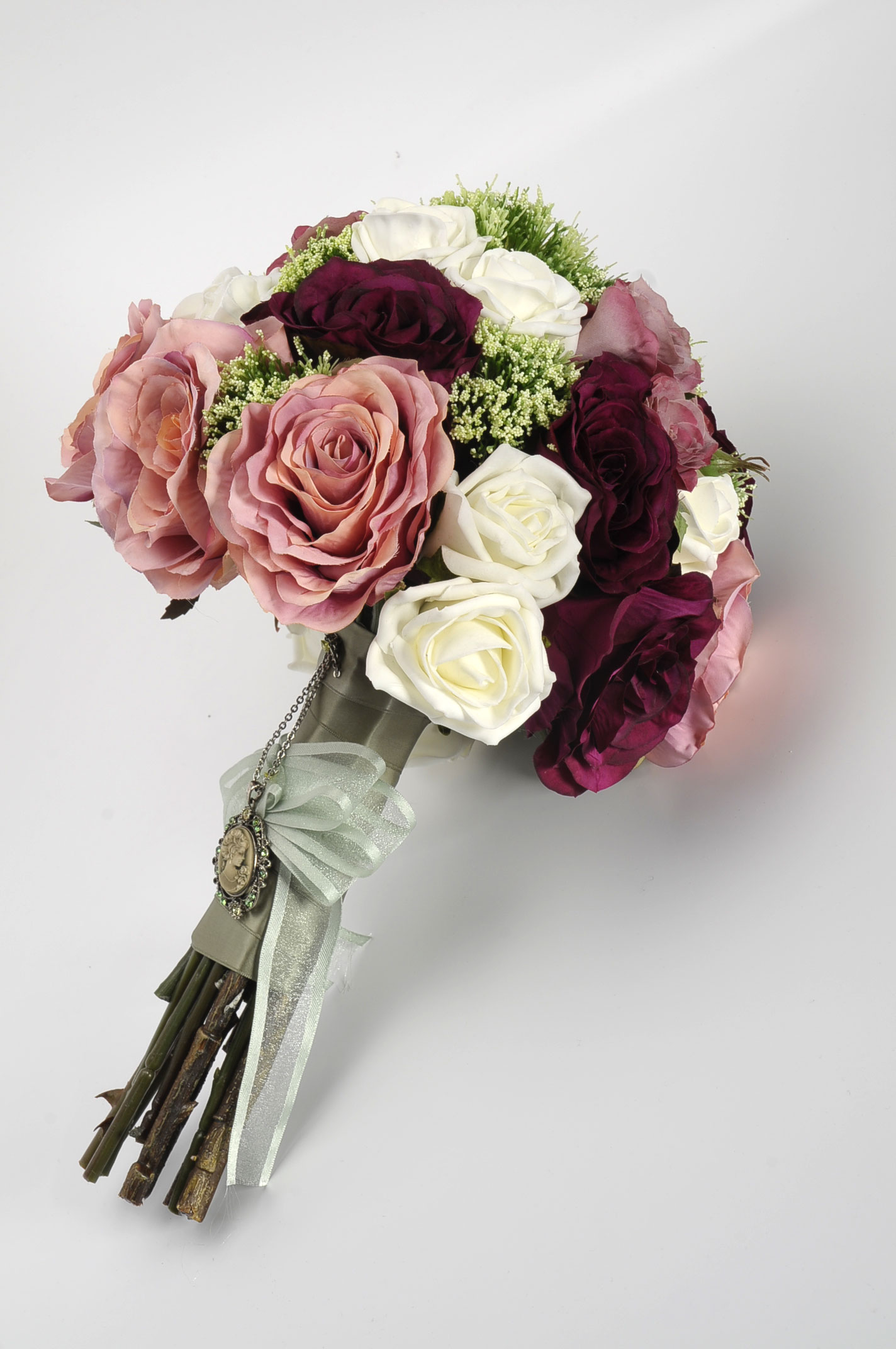

How from the filename? Or do you mean from the EXIF
Looking at the EXIF data, I think you're right, but it's not obvious:
Code:
Color Space                     : Uncalibrated
Interoperability Index          : R03 - DCF option file (Adobe RGB)
Interoperability Version        : 0100

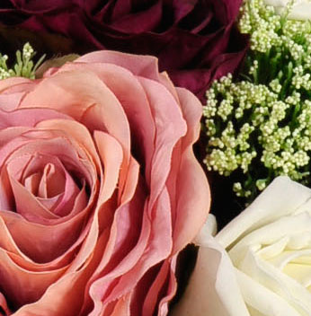

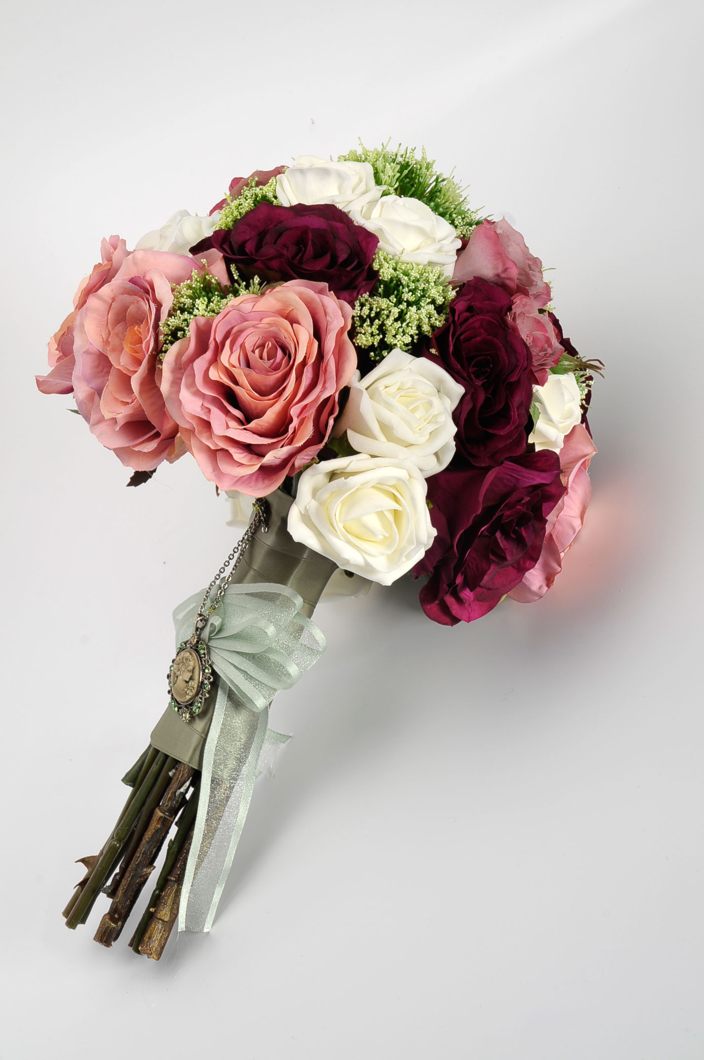

This is what it looks like converted to sRGB (if I've done it correctly)
This may or may not look different in your browser - depends on what is in the file and whether your browser is colour managed. It looks WAY better in mine.

Looks the same in my browser because I'm using Safari ;)
Nikons start filenames with an underscore to show they are in 1998. So DSC_1234.jpg is in sRGB _DSC1234.jpg is 1998.
Oh cool. Will have to remember that.
Important point though. Not all browsers are colour managed. This is what it looks like in a non-managed browser (again, if I've done it correctly) Edit: yup, done correctly as far as I can tell... This should look washed out compared to the others...

Your problem is definitely about using the wrong colour space. Some web browsers are not colour managed - they make your photos look washed out. Just download chrome (you don't need to use it as your main browser) and view this thread and you'll see what I mean. You may say that it's a browser problem (and you'd be right) but that doesn't mean 20% (and growing) of your customers would be seeing a washed out picture. You need to save as sRGB - again, the image you posted of the pink roses is washed out.

PS. the Scottish flowers are a bit subdued as well. You may not see it on your system, but it is washed out and it's because of the colour space you are using. I'd suggest what Jonathan has said:

Cool. I should be able to tell the difference if you post two. Here is a cutout of the same area of the images. One on the left is saved "properly" (i.e. sRGB) one on the right is with Adobe RGB and saved as is (but without the colour space information so managed browsers don't know to apply the Adobe 1998 conversion so it looks incorrect)
You should be able to see the colour difference there (the one on the right is washed out in comparison to the one on the left). Absolutely NO processing applied to these apart from colour space settings.

BTW... the difference between the two images above, whilst still apparent, is not as large on my calibrated works laptop screen as it is on my calibrated Dell 24" IPS panel. The difference is there though...
Well, I must have taken a few hundred test shots today with a range of different light positions, f-stops, shutter speeds and ISO settings. It's true when they say that the first 90% of progress is achieved in 10% of the time. The last 10% of progress is taking the rest. I just can't seem to get the pictures the way I want them (like this):
OK, so I've not painted the walls grey yet or the ceiling black but I did install the DX2 mode 1/I and the results were a little weird. Over saturated and dark:
I played with the sRGB and Adobe colour settings but I couldn't get a nice shot in DX2 Mode 1 so I reverted back to the Neutral colour profile on the camera. The best shot of the day was this one (helped along I'd say by the natural light that was in the room:
Even with ISO 200 and the beauty dish as far away as possible, we're just not getting the right results:
I know it's impossible to get the effect of a bright sunshining day but I'd hoped for better results than we're getting. I think I need a bigger photo studio so I can push the subject out into the centre of the room and walk round it for the different angles. Unfortunately, we don't have a bigger room for photos :nono:
As always, keen to hear your responses and advice.
Did you try upping the power on the overhead flash? They still look underexposed (although they look right colours to me now).
And what do you have the colour balance set to. The second shot you have looks warmer (redder) than the first. If you are on auto colour balance, it may be this that's causing the problem.
Do you shoot RAW at all so you can play with the colour balance to see what it looks like?
As to getting the beauty dished flash further away, how long is the corridor/room you can see to the left of the table? Could you put it outside there?
Other way round.
Forget about the exposure for now, it's the ratio that's wrong, you need more light from the beauty dish or less light from overhead, which is why I suggested moving the overhead softbox further away, to effectively reduce its power. Once you've got more 'kick' from the beauty dish (relative to the overhead light, which is in effect just an off-axis fill light, you'll get more local contrast and therefore more 'sparkle'
And then you adjust the exposure (aperture) until you get the effect you want.
You're still getting too much unwanted reflected light, which is mitigating the effect of the hard light from the beauty dish.
