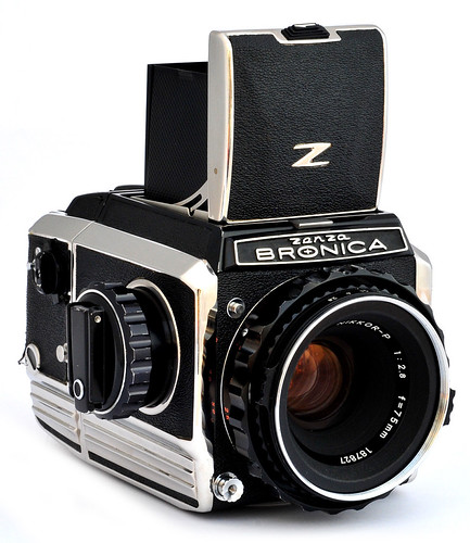

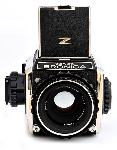

Here is mine - tell me that ain't gorgeous...
Me Bronica S2A by Ali Lampard, on Flickr
Gorgeous indeed - nearly as many shiny bits as a 60's Cadillac - is it you that owns the fabled "unicorn" S2A? (the only one that hasn't broken down?):D
Tsk.... just vicious hearsay propagated by Hassy nerds...:p
