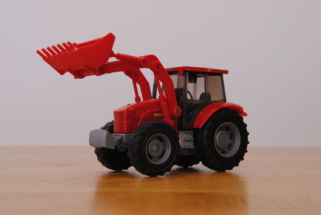

So here is a photo taken without any filters and is therefore the control shot. All were shot with my D3000 with a Nikon 17-55mm f2.8, all set at f6.3 and ISO 400 (to keep the exposure times sensible). This wasnt helped by the fact I dont have a shutter release cable and on bulb mode on the D3000 you need to keep the button pressed, which after a while wasnt much fun! Dont know if this is the same on all cameras?
Control shot: 1/15 sec, f6.3, ISO400
2012_07_22-323410-Stop-TEST=1/15 sec by Tunbridge Wells, on Flickr

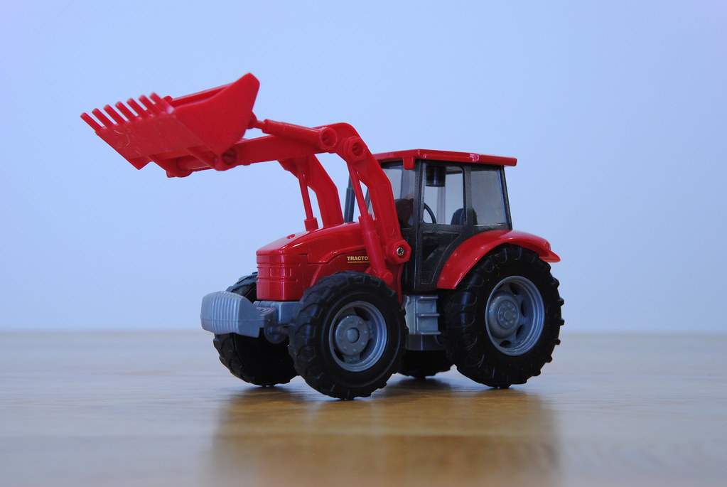

With ND3.0. I set the time as 60 sec as this should be the correct exposure for a 10 stop filter and got this, which looked a bit dark
2012_07_22-323510-Stop-TEST-60 sec by Tunbridge Wells, on Flickr

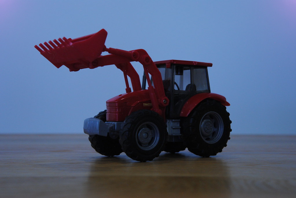

So I tried it at 90 sec. A bit better but still a bit dark?
2012_07_22-323710-Stop-TEST-90 sec by Tunbridge Wells, on Flickr

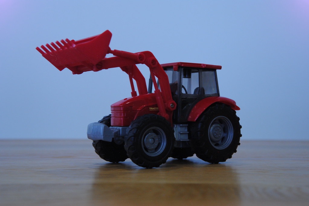

Again at 105 sec
2012_07_22-323210-Stop-TEST-105 sec by Tunbridge Wells, on Flickr
