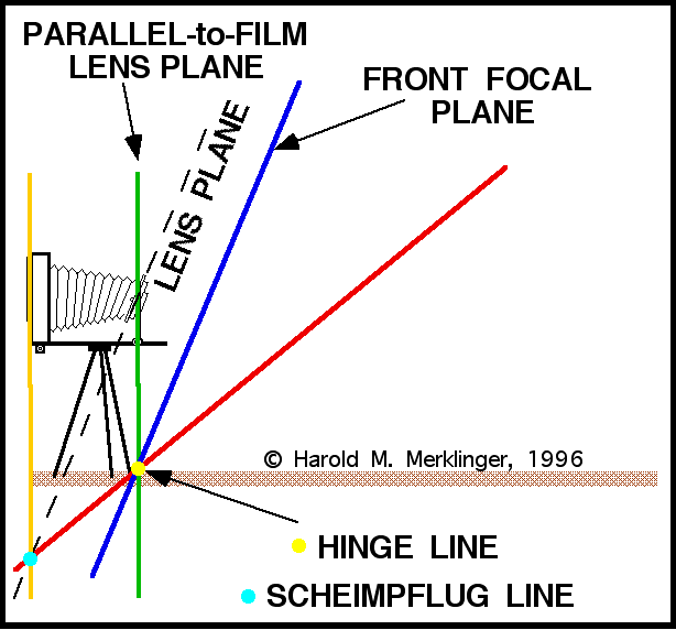

That first diagram highlights nicely how tilting down increases the plane of sharp focus. So to achieve this the best of sharpness, where do I want to be focusing on the chilli pepper in my example?

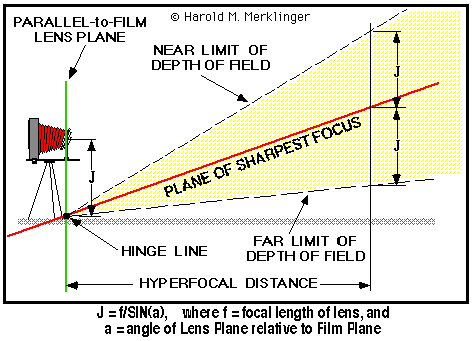

Unfortunately it's not as simple as just tilting an arbitrary angle and refocusing somewhere on the subject. Unless you calculate DOF ranges for your tilt angle nobody can tell you that precisely. Some people do precalculate spreadsheets of the DOF ranges for different tilt angles to give an idea in the field how far to be and what angle to use.
Harold Merklinger describes it in his free books available at his site and more condensed form (as articles) here.
The imo better illustration of DOF on tilted lens (taken from here):
The clearer illustration of how DOF changes with focusing:

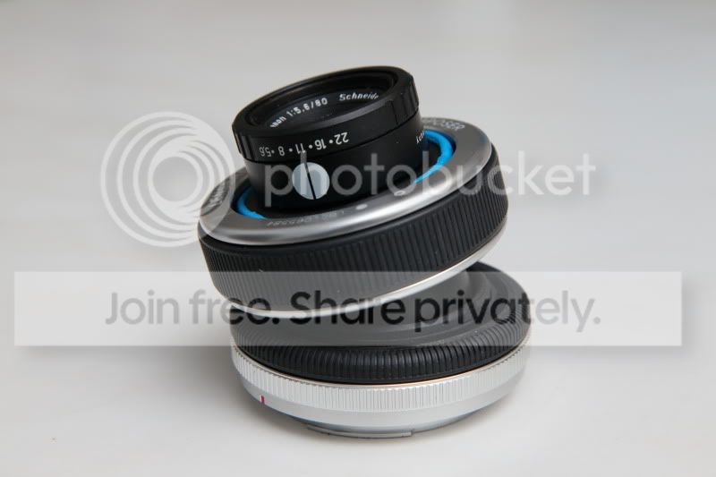

Here it is then, my Schneider 80mm f/5.6 LensBaby Tilt lens. Cost £15 :D And it works :) I see just this week LensBaby have announced an adapter to do something similar with Nikon lenses on 4/3rds cameras - cost $250.
As mentioned above, I bought an old Schneider Componon enlarging lens off the web for £15, and BluTacked it into a LensBaby Composer mount. It works fine, but the lens is old and a bit cloudy so the image quality should crispen up a lot when I get around to cleaning it. I also need to mess about with the mount to make the most of the limited amount of focusing movement on the LB Composer.

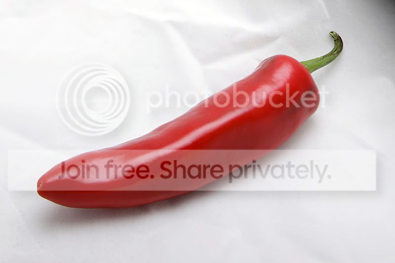

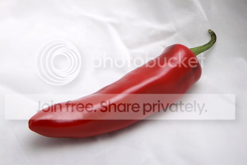

I had a try at the Chilli today, took me a while to find one that was exactly 4" long (without the stem).
I used my 24L f3.5 TSe Mk2 with a 1.4x Extender giving an approx 34mm f5 T/S lens.
I set maximum shift downwards to prevent my having to tilt the camera down as much as would have been required otherwise and used the full tilt as swing to put the plane of focus between the tip of the chilli and the end of the stem.
Lit with a single flash above a lightcube.
At a registered f5 (actual f7.1) at ISO 50
At a registered f10 (actual f14) at ISO 200

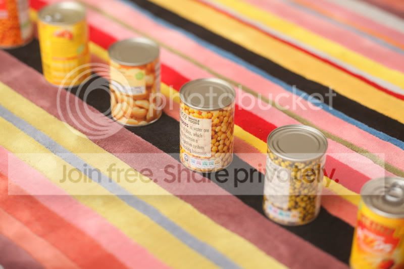

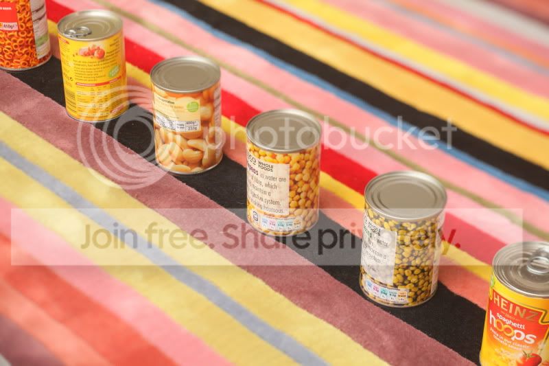

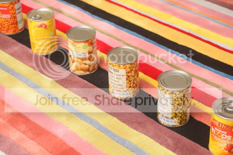

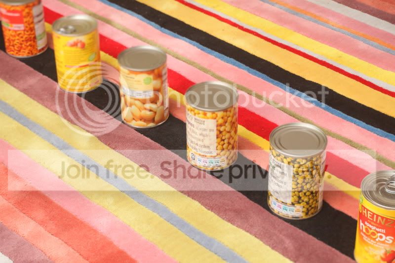

Messing about with my DIY tilt lens (as in post #31 above). My missus hates this carpet, but I like it, and it makes a good subject for this Schempflug business. All at f/5.6, 5D2 and bounce flash.
First pic is with the lens set square, focus on the middle tin, normal DoF with sharpness fading front to rear.
Second pic is with the lens angled downwards to maximise DoF across the carpet front to rear - regular Scheimpflug adjustment.
Third pic is reverse Scheimpflug, lens angled upwards, to minimise DoF front to rear.
Fourth pic is reverse Scheimpflug and with the lens angled upwards and to the right, tilting the plane of sharpness across the image diagonally in line with the tins. This is the technique used in a lot of David Loftus' shots in the book Jamie's 30 Minute Meals, as mentioned above. The book is worth getting just for the photography - £13 Tescos.

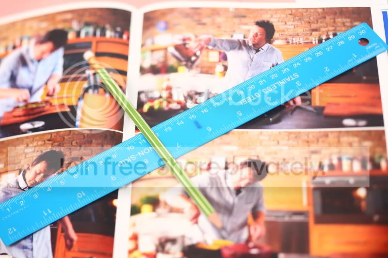

Last pic - work this out :eek: It's a spread from the book, shot with reverse Scheimpflug applied up and left so that only the ruler is sharp. The images in the book shown are taken with left-right reverse Scheimpflug applied, which you can see clearly in the top shot.
Lens set square, normal DoF sharp across the middle, fading front and rear
Max DoF - normal Scheimpflug applied, carpet sharp almost all over
Minimum DoF - reverse Scheimpflug applied, narrow band of sharpness across the middle
Angled minimum DoF - reverse Scheimpflug angled right, narrow DoF in line with the tins
Angled minimum DoF - reverse Scheimpflug angled left, narrow DoF in line with the ruler
