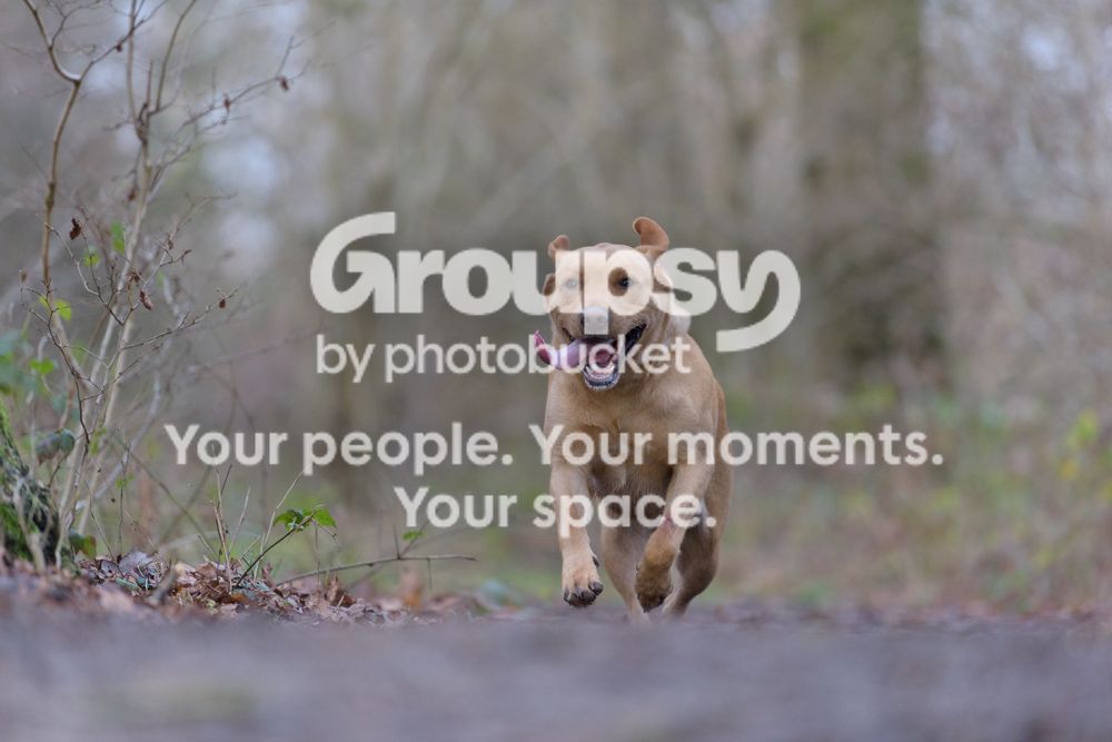

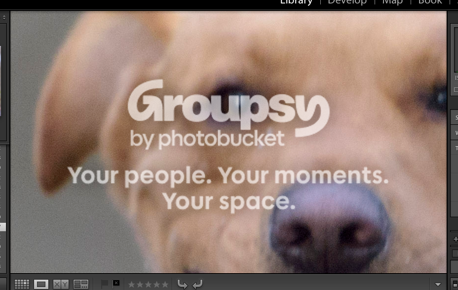

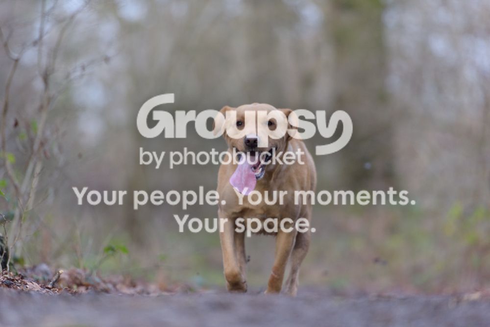

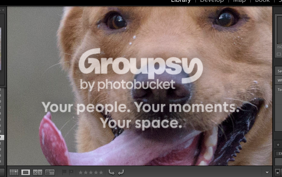

Here are a couple of examples, both shot at 200mm, f2.8, 1/500th and Auto ISO, which was 1250 in this case. Both completely unedited, just converted to small jpeg from the raw file.
First one is acceptable IMO, face is reasonably sharp at 100%
Second one not acceptable, and was the very next frame after the first photo. You can see that the focus is behind the dogs face, and you can see how shallow the DOF is on the vegetation on the left.
