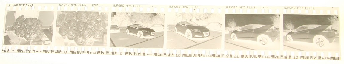

Can you post a pic of the negs held up against a widow/lightbox, only real way to tell if development is an issue.

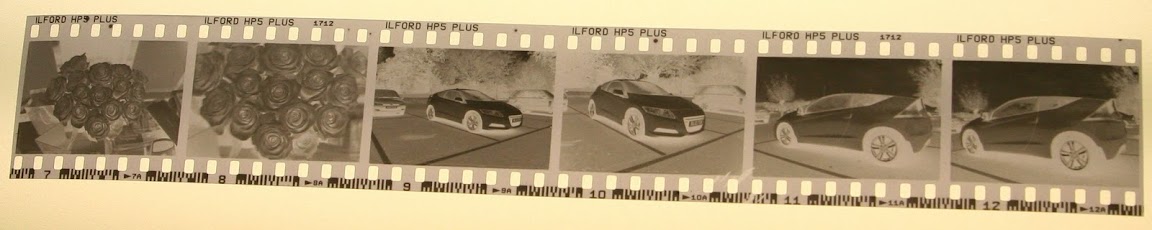

Pics of Negs:
I am pretty confident I have under developed by 2 mins.

EDIT: the scratches are down to another mistake. I put the film down on a sheet of paper and it stuck to it, so despite re-washing there is still bits stuck to the film and I have probably damaged it from the re-washing.
Puggie Going by the top set of negs they look to be OK, the last 3 shots of the car my be under exposed a little-but should print.
