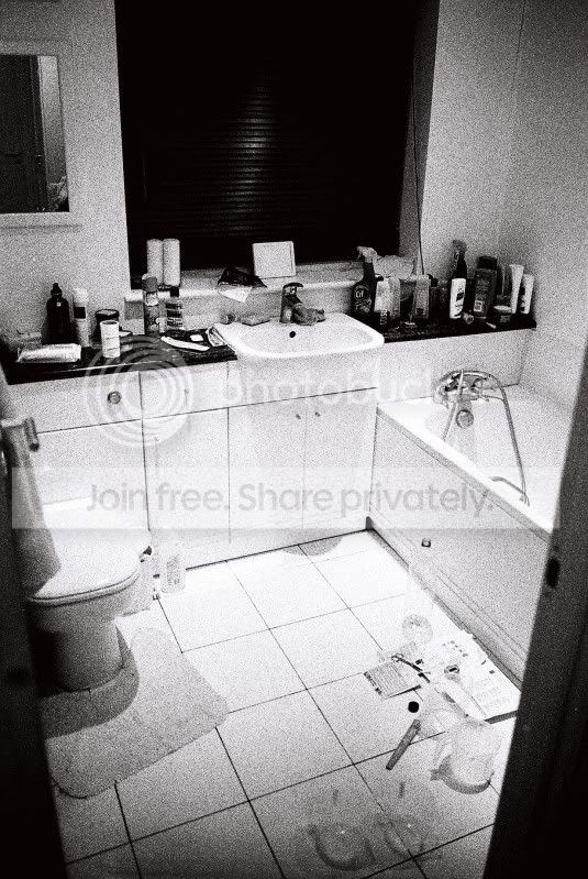

I just literally finished chopping up my negs!! Shot a full roll of HP5 in my kitchen and developed it with my new kit in the bathroom.
7.5 mins in developer
30 seconds in stop
3 mins in fixer
Very very pleased, the negs look excellent and it all went without a hitch!!! Looking forward to getting some prints tomorrow for you to see. Thanks very much for the help, I'm really looking forward to trying more shots.

Here are a few images from my first roll. I couldn't get prints because it would have cost more than just giving them the roll (something to do with the fact its easier for them to develop+print than to print from negs?) so I got them scanned to CD for 97p, but as I haven't tried this before I can't really compare the results with anything else I have had developed.
They look rather grainy, I like the effect but wonder if there was anything I may have done to have enhanced this effect? What do you think? The pics are just some test shots, I used a whole roll just taking shots of my kitchen!!
