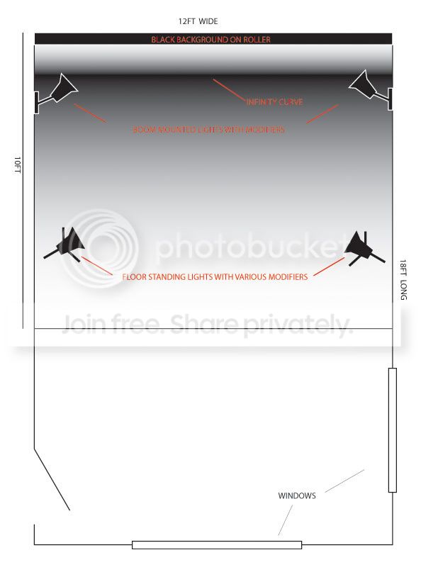

So the build begins.
The space for the studio has now been (almost) cleared and the concrete base will be put down next week.
The building is on order and will take about 3 weeks to arrive, so plenty of time to get sorted (weather permitting)
Im a bit restricted by the amount of land i have spare so the studio will be 12ft wide x 18ft long and the height around 8ft. Not massive, but about right for what i need.
On the far end will be an infinity curve, rear and floor painted white and extending approx 10ft from rear wall. Then wooden flooring continuing to the "shooting" wall.
There will also be a black background on a roll above it to pull down when needed.
Because i want complete control of reflected light, the side walls and ceiling will be painted black up to the end of the white floor.
White walls the other end and windows with blackout blinds to keep that end brighter if im just showing images to people etc.
Ive attached a rough diagram of the layout.
Would appreicate any advice from anyone who has done similar.
Dean.
I can't help wondering what the floor standing lights are for...
Hi Garry.
The rear lights would mainly be for lighting the background for white b/g shots, or, using as effect lights with a black or grey background. The front 2 lights, well tbh, i dont need 2, i just have 2. I expect to be using 1 the majority of the time with either a beauty dish or softbox. I'll probable be using it mainly on a boom stand. Ill use reflectors whenever possible, as using another light just complicates things. I like simplicity ;0)
Dean
I think you'll be surprised how small your studio gets once it's kitted out and you've moved the gear in. I also have a separate studio at the end of the garden which coincidentally is 18'x12' - though mine also doubles (trebles?) as a home cinema and music room and has a wash room as well. As you are going to the trouble of building an infinity curve, I'd continue this into one corner and a few foot along one side wall - this would then allow you to shoot diagonally as well so as to maximise the distances between camera>subject>background. Wall booms are great and with a 12' width you can potentially cover all the width of the room - don't have them too close to the corner. As for stands. get them with wheels it makes positioning the lights so much easier not to mention safer. There is a very successful US photographer that uses a very small studio and his number one tip is get 'grids' for all your modifiers to ensure you have the best light control you can get (softboxes, beauty-dishes..).
Paul
My studio is even smaller, one bit of advice from me would be to buy collapsable soft boxes! That way you can collapse them down to save space when not in use, building normal ones or trying to find a place for them when not being used is a pain.
Thanks for the advice guys. I'm hoping to keep the place clutter free, but in sure it'll fill up quickly. Will defo look at foldable gridded softboxes.

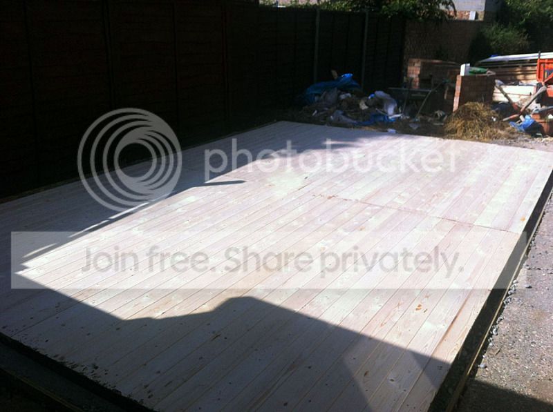

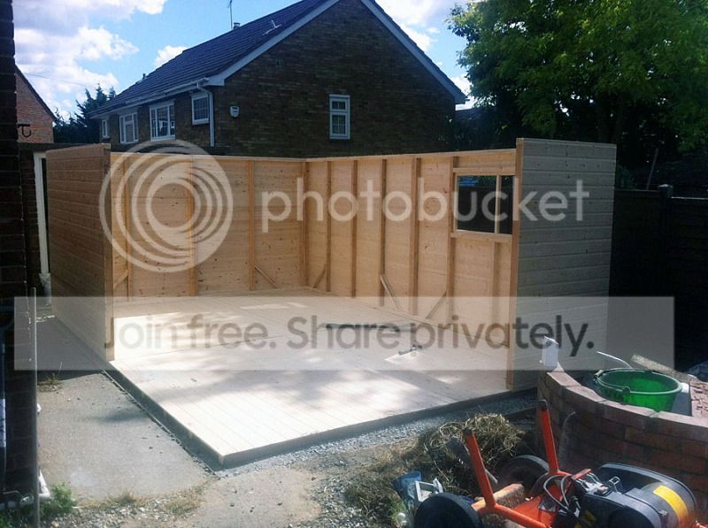

Ok, so got rained off yesterday, but had a good bash at the build today.
Wooden base goes dow on top of concrete base.
Walls start to go up.
Front side fitted.

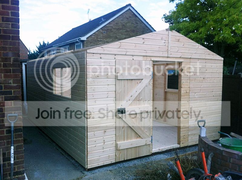

Roof on and started to felt.
After the roof is finished, the whole studio will be plasterboarded out and the infinity curve fitted. Then the electrics, alarm, smoke detector etc.
Dean:)

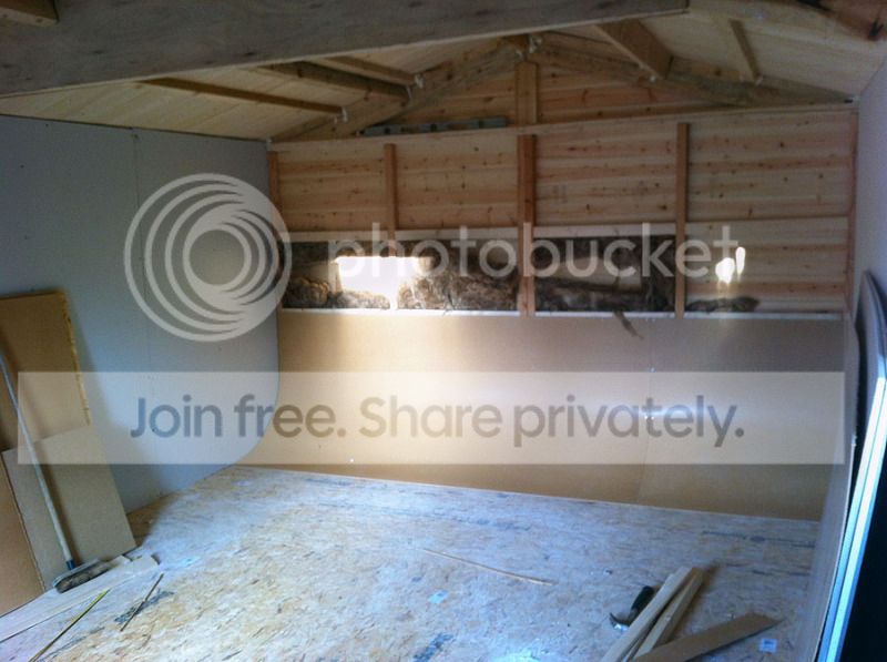

Hey Carl,
Wasnt sure anyone was watching this thread.:LOL:
Its not far from being finished, ive finished the plaster boarding, and now working on the infinity curve.
Once thats done, its just a case of fill, paint then electrics.

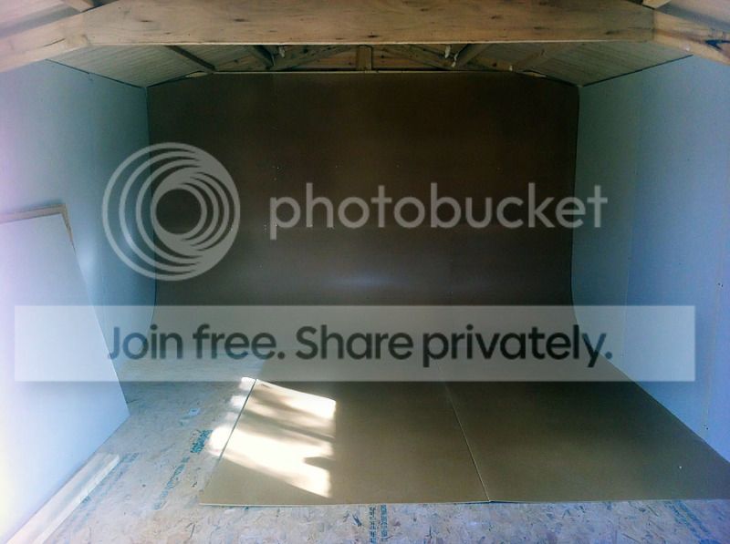

Hi Guys,
Been a little slow the last couple of weeks due to work commitments.
Here is the start of the infinity curve on the rear wall.
The plasterboarding is pretty much finished.
As soon as the curve is done its time to fill and sand everything.

Another quick update.
Infinity curve almost finished, just laying down the curve flooring before fixing.
Then fill & paint.

Hi, progress the last couple of weeks has been slow owing to B&Q letting me down on a delivery and me and the wife having a break in Cornwall.
There has been progress, all plasterboarding is complete. The windows have had sills fitted. Its all ready for fill, sand and paint. As soon as its painted, I'll post photos up of the lights going in.
Thanks to those that are keeping an eye on the progress.
Dean :0)
