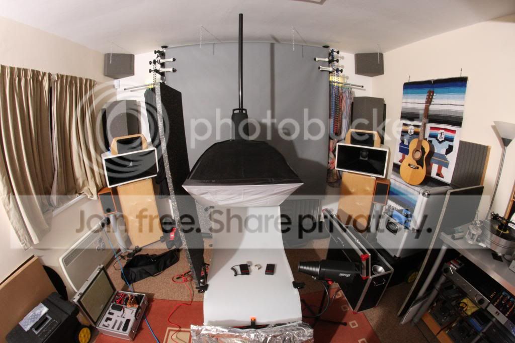

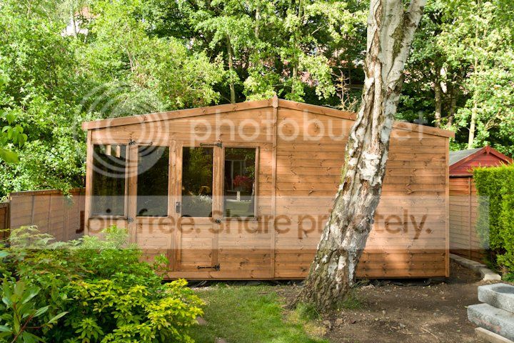

This is what I ended up with at the bottom of my garden (photo from a few years ago when just finished).
I still call it the 'Shed' as it is where I hide away and indulge my hobbies - Photography is the third use, the first being as a place to put my stereo which has a zero Wife Acceptance Factor (WAF) it also has a ceiling mounted projector for me to watch movies. As a consequence it is very cramped and one of the main storage areas inside is in the loo (yes full plumbing and electricity) but it's a constant battle to keep it tidy when doing a little shoot. Last night it looked like this inside;
The swinging of cat's isn't allowed;)

Even photographically minded I still skipped the shed and went straight onto ooooooooo i want that turn table :p audiophile much ?

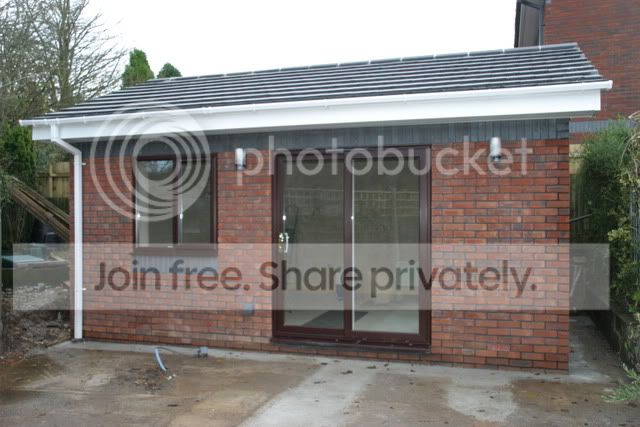

Ok guys, here are a few pics of the build.
This shows the curve being painted.
Looking back towards the door end. You can see the black ceiling in the top. This is to stop reflections.
Here you can see the full curve and floor being painted. It's 12ft wide, 6'6" at the edges and 8ftin the middle, and the floor is 10ft deep.

The complete building + everything to decorate, power etc is coming in at just under £3k.
