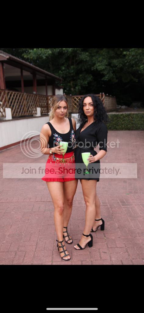

    Maybe my pics are ok?
    [​IMG]
    I just thought it had something to do with what focus mode / focus points

    To be honest that looks all out of focus except for the floor in front of the models, you need to make sure the camera is focussing on the eyes, or at the very least the head.
    Also, it is shot at too wide an angle to get decent subject-background separation so there's an issue there.
    Also, you really really need to pay attention to the background of your shots, a distracting background (such as this) can ruin a shot.

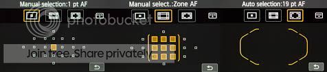

    Which one of the below would you use when shooting more than 1 person?
    [​IMG]

    this next question is prob a basic question, sorry, im new.
    For the shot above of the girls, does it matter if I zoom in with the lens to get the shot, or is it better to not zoom in at all, but zoom with my feet?

    I would use the first one and move the focus point so it is on the face.
    A couple of things... if you use too wide an angle you will distort the subject and they will look odd so you don't want to use wide angle unless you can avoid it. You get more background blur if you use a longer focal length. So, you should use it as 'zoomed in' as possible although with your lens that isn't very far (but maybe far enough)....

    It doesn't matter how you zoom in, it's all dependent on what you want from your shot.
    A combination of zooming with the lens and standing closer to the subject will result in more out of focus background and isolating the models, if that's what you want (I'd suggest in this example, you probably do - the background is not that interesting).
    Obviously you need to get your focus on the model's face nailed though (shouldn't be difficult with your gear).

    Complicated way... single point AF and move the focus point to where you need it, i.e. eyes/faces. Simpler. single point AF leave on the centre point and focus and recompose (1st is potentially more accurate)

    There is only one plane of focus.
    So if you want shallow DoF you really need to ensure both subjects are the same distance from the camera.
    Then focus on the eyes of one of them, preferably by choosing an appropriate single focus point.

    You’re misunderstanding the zoom of a lens, your 18-35 lens is effectively a wide angle (18) a semi wide (23) and a standard (35) lens.
    Focal length is completely different to ‘zooming with your feet’*.
    *experiment in the world with no pressure, use different focal lengths and then move to frame your subject to the same size, you’ll see how remarkably different the photos are.
    But the simple answer to your question is that if that’s the only lens you have, use it at 35mm for the shot you’re asking about. As above, id choose a lot longer if I were to take it.

    As above, it’s out of focus and shot too wide and the background is distracting.
    In short... far from ‘ok’, but follow the advice here and you can do much better than ‘ok’.

    I used the following:
    Canon 5D MKiii EF24-70mm f/2.8L II USM @ 70mm F3.5 125
    Teflon-Mike likes this.

    But importantly they’re not full length.

    Wrong lens, wrong camera height.
