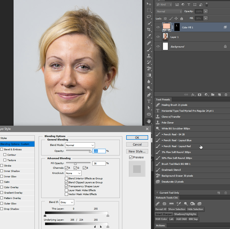

No sure what software you are using to process the image, but with Lightroom you could try down the whites and highlights just a bit if you are working in RAW. Ideally a professional make-up such as Mac would help but as I found out earlier this year it's not just a question of powder it's also the foundation as well. So probably not really suitable in your case. I don't think moving the flash would make that much difference as it's the reflection off the skin that's the problem. I've never tried it but I wonder if a polarising filter on the camera may help
In Lightroom, clone a section of non-shiny forehead over the shiny bit, then reduce the opacity so that it shows some of the shine through but is significantly reduced.
This technique will also work with the bags under her eyes. Always reduce those, as it's the first thing women see in their headshots.
