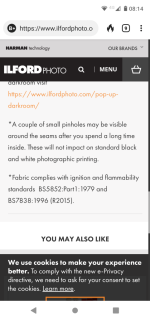

From my perspective the only possible caveat to StephenM's comment is this partial disclaimer from Ilford:
