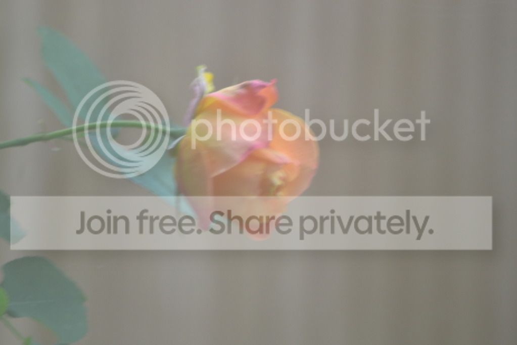

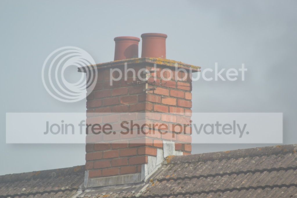

the real issue is that the pictues appear foggy only done a few test shoots but they all appear this way ( picture one ) compared to my stock lens ( picture 2 )
does anyone know what might be causing this, thank you in advance lee.

assuming you are not having a bit of a pea-souper in bristol, and it isnt absolutely hissing down with rain, that image is VERY foggy & odd.
Do some more test shots in good light, lets have a look at them, and yes you will have to manually focus, at least until such a time as you decide to upgrade the body to one with an AF motor built in - although I have a horrible feeling that lens might be going straight back to who you bought if off unless the fogging issue can be resolved.
Was the sun shining directly on the front element of the lens you were using? The bit of wall/window is showing no strong shadows but seems reasonably lit, so it's a fair assumption that the sun was the far side of the house and could possibly have been falling onto the shooting position. IF it was hitting the lens, the fogginess could be a pretty horrendous case of flare, probablt exacerbated by either a dirty front element or filter or the fungus. Were you using a lens hood? Unless the lens was described as having fungus by the seller, I would return it to the seller as not as described.

That first picture is very foggy, more than a tiny patch of fungus would cause. The best way to see fungus is to hold the lens up to a strong light source (a table lamp with a plain shade is good - an unshaded light bulb is too bright I find) and look through with the aperture wide open. I use a magnifying glass. Also change the focus and zoom so the different lens elements move and come into focus. There is possibly more fungus or hazing going on here and you need to check the surface of each element.

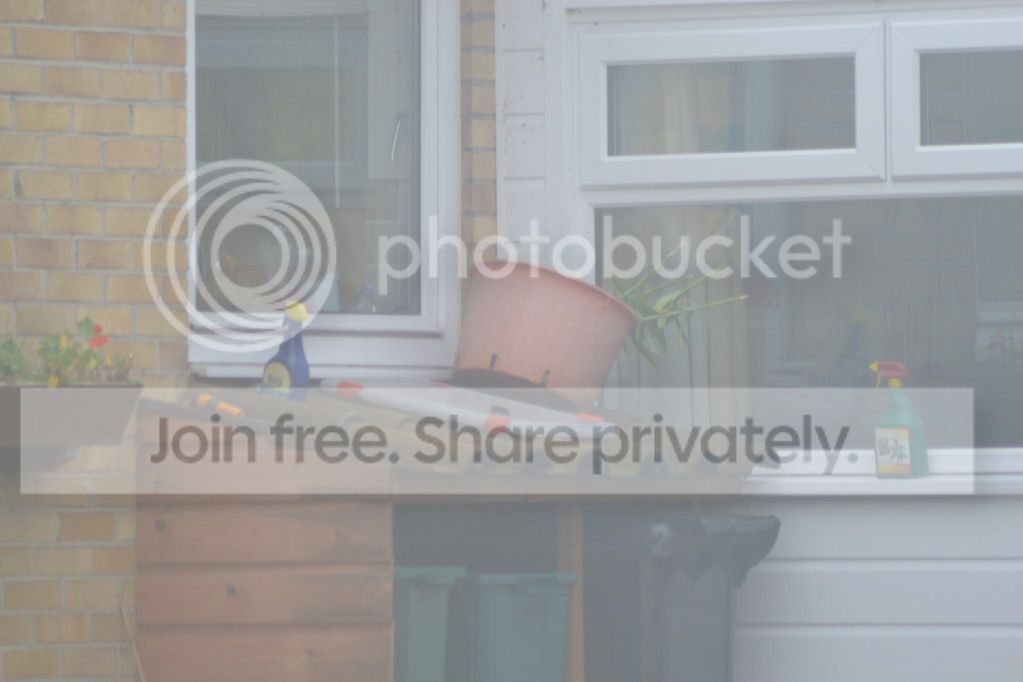

i knew of the fungus but he did say that the picture taking was not affected in anyway ive tried a few different pictures and all come out hazed with a lens hood and also a hoya filter attached / unattached, also im having trouble getting it to focus at all when its on 70mm ??

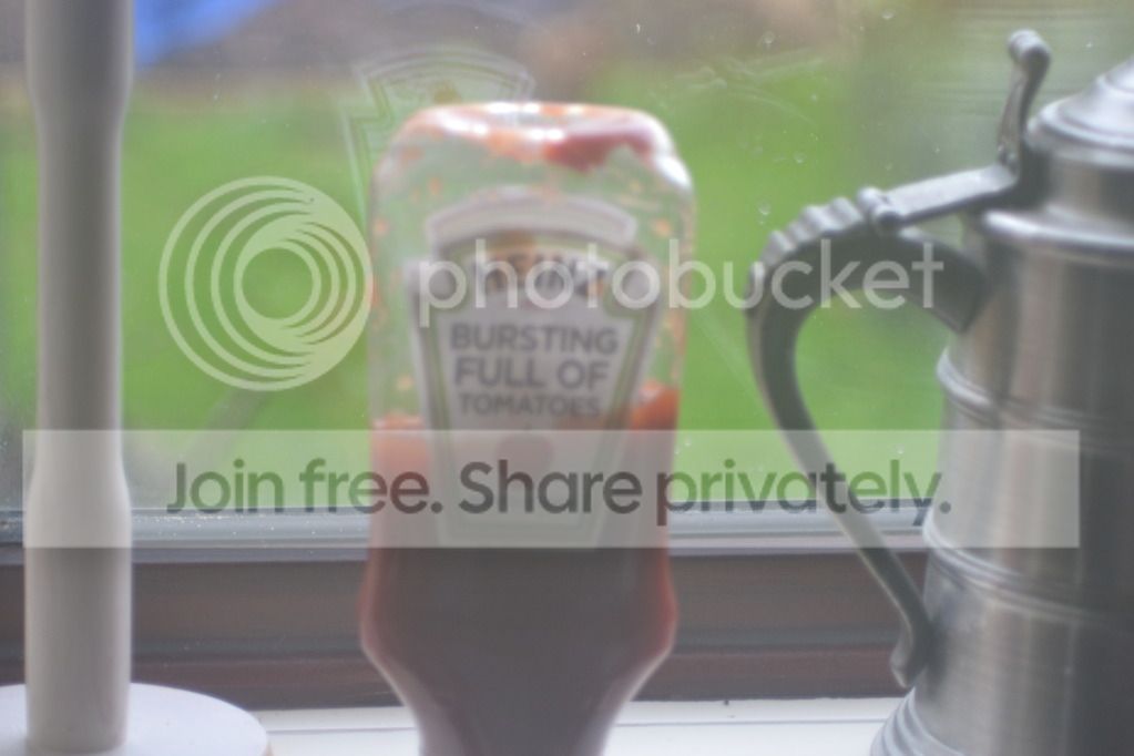

edit a few more examples
im just having a guess here but could they have had a go at cleaning it ? hence the haze? or could it be oil, i would return it as not as described i have seen photos taken with a fungus lens thats not fungus thats oil or some sort of cleaning fluid thats been used on it
