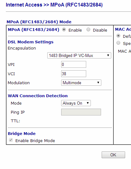

PS. This is how I have the modem setup here:
EDIT: these settings are correct for a connection provided by OpenReach (i.e. on anything using BT lines back to the exchange). If you use an unbundled provider (that has their own equipment at the exchange) it may be incorrect.
OK, that encapsulation setting differs from mine which is 1384 Bridged IP LLC
