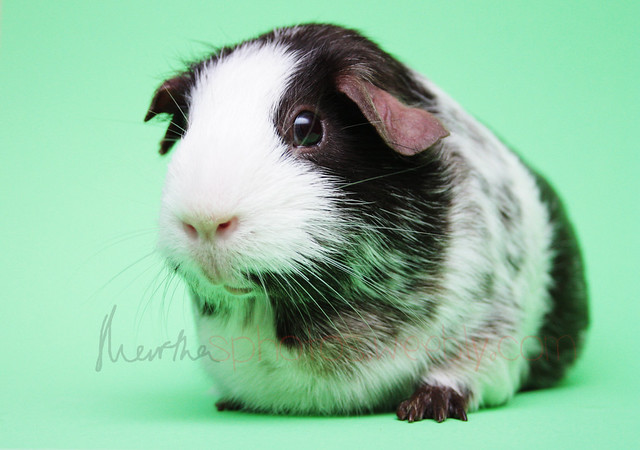

Hi, thank you Kim for posting here, I was having a nightmare explaining what was wrong.
Here is what is wrong, and I do think as you have said that it is the way I have lit the photo that is the problem, and the light is bouncing off my background onto the subject. It's only doing it to their underside though...
Cherry in the Green by Vi27, on Flickr
This one is perhaps the worst effected, the green has almost taken over the subject. It's a real shame as otherwise i really love the backgrounds.
I am using A2 card, so it's not a very large area I am working on. I don't know how I could possibly get them further away from the background, seeing as it's the bottom that is being reflected, not the back...
Again thank you Kim for asking, and to those who have given answers already xx
Well there's your problem...
The light from your flash is bouncing down onto the 'floor' and then bouncing back up from the floor, picking up the colour as it goes (reflected light aquires the colour of whatever it bounces off)
Take your flash off the camera, and maybe use a white floor? :thumbs:

The backrgound will inevitably reflect off the subject. You can reduce it by cutting out any area of colour that doesn't appear in the shot and moving the background back, but it will always be there.
This is the right answer, all other answers are wrong and won't help.
There are just 2 ways of getting around this problem, other than the obvious one of not using a coloured product base.
1. Sit the subject on a glass shelf suspended well above the base. Depending on the angle at which light hits the base, this may or may not be a complete answer - but it's the best there is
2. Photograph it on either a white or a black base, cut it out in PS and stick it on a background of your choice, then add a shadow to make it look real.

I didn't say that everyone else was wrong and that I was right, what I actually said was that everyone else was wrong and that Richard was right. And I didn't bother to explain why he was right because he had already given the reasons

So you're saying the colour being reflected to the underside of the Guinea pig is coming from the background? I would say that's light picking up colour after reflecting off the floor having already bounced off of whatever surface it was bounced off originally. I can't see how I'm "wrong" and being unhelpful :thinking:

The 'floor' and the 'background' are really just different names for the same thing when the background is also the floor of the product, and as Richard has already explained, light will always reflect from any adjacent surface onto the subject. In fact, it will always reflect whether it's adjacent or not, it's just a question of degree. In this case, the reflected light is green because the product floor is green, which filters out all visible light except green. By placing the subject on a glass shelf as I suggested, the light has further to travel from the coloured product base (floor) and so will have less effect.
You get exactly the same effect if you photograph someone laying on grass. It's inevitable.

So, in essence, Ste was also correct.

The light is being reflected off of the floor up at the guinea pig, and picking up the colour.

In the sense that the problem is caused by colour reflected from the product base, yes. But taking the flash off camera won't help (at least not with this) and neither would using a light tent.

Yeah, sorry, I meant he was correct re cause not solution.

Probably the easiest way would be as Garry suggested and to shoot on white, do a cut-out in post production, mask the animal, and then overlay a colour to the background and floor.
It needs a bit of photoshoppping skill, but it's actually quite an easy subject in that respect, with a relatively simple outline apart from a few places.
Even if you do the shoot on glass thing, you will end up with the little fella floating in space and it will then need a shadow creating for it to sit on and appear natural. And you might still get some unwanted colour in there, even then.
ChromaKey is another possibility, but that's really a video technique when the PP thing isn't an option. Always looks naff though IMHO.
Suggestion - shoot on white and just add the colour as a vignette in post. Real easy, might look nice?

Be aware that you'll be adding a white bounce instead of a green bounce - not as obvious, but may still be undesirable (or alternatively, may be a helpful fill light...)
In video terms, over-lighting a chroma key is the most common mistake (even in broadcast use), although you always light background separatly from the subject. Its surprising quite how little light is needed!
The solution to stop nasty colour casts is basically the same whichever way you do it - either less light, or better separation between subject and background (which is two ways of achieving exactly the same thing when you look at the physics of reflected light...).
As you have a single light source for both subject and background, you are a bit stuffed unless you move the subject further away! Maybe reduce the flash power, increase sensitivity of camera, and use more ambient light...?
