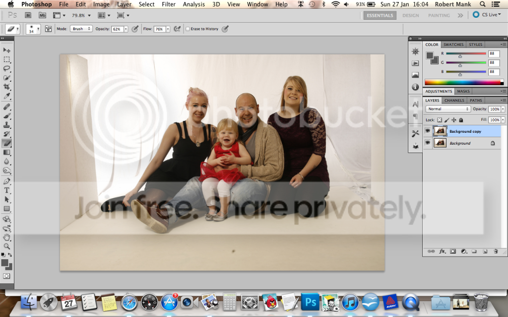

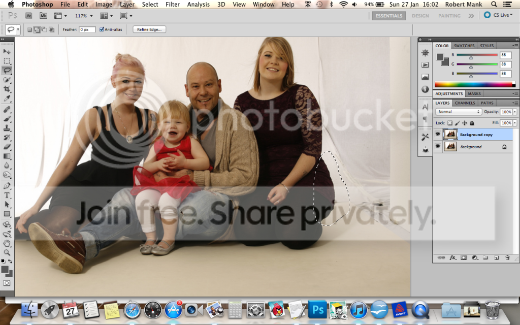

I duplicate the background. Use the lasso tool to draw round the area and a bit of background:

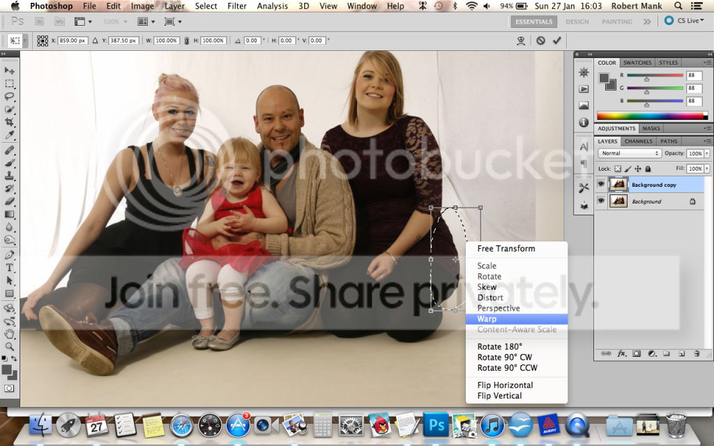

Then I free transform (cmd+T on a mac) then right click and warp:
Then just pinch it in where you want it to as much or little as you like.
If its a bit messy in the corner use the eraser tool and brush it out.
Hope this helps Craig. :)
