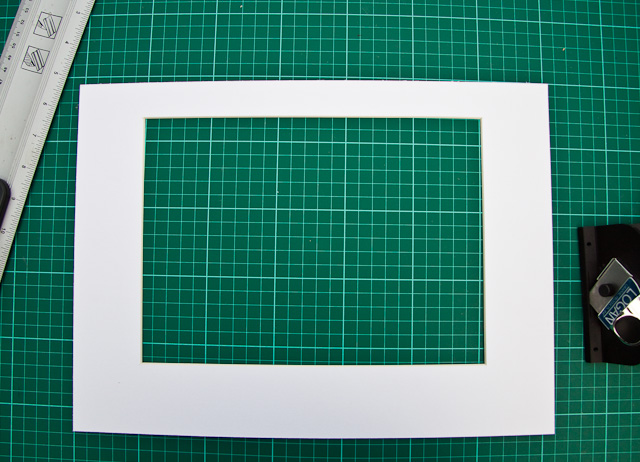

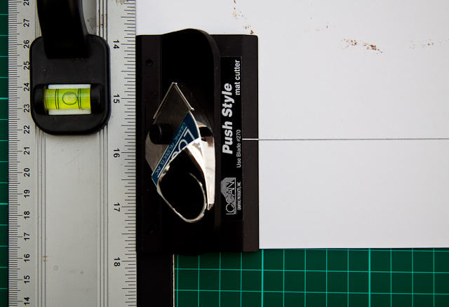

3. Cut the mount.
If you screw this up, your mountboard goes in the bin. Take care!
One problem I have with the mount cutter is that it slides like a greased monkey down a pole across the cutting mat. One hefty push and you've sliced your mount into bits. To combat this, I ALWAYS rest a bit of scrap mountboard under the cut I'm about to make. The mount cutter then "bites" into the scrap and is much more controllable.
If you're left handed, reverse these instructions!

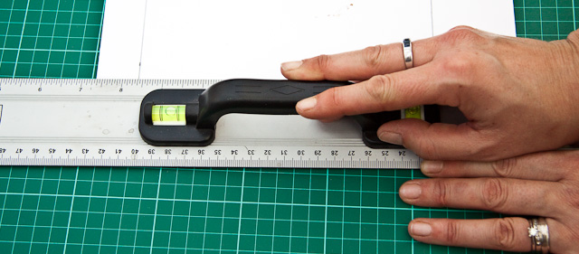

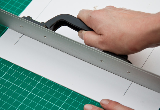

- Hold the ruler in your right hand. Offer it up to one of your lines, JUST INSIDE the line.
- "Roll" the ruler down so it's flat. Don't let it move. Swap hands so that your left hand is now holding the ruler down.
- The mount cutter should have a white marker. Slide it up against the ruler so that the marker is level with your perpendicular line.
- Push the thumb-slide down. This will make the first cut. Keeping the slide locked down, slide the mount cutter along your line, tight against the ruler, up to the other intersecting line.
- Release the thumb-slide
- Repeat for the other three lines.
- Lift your mountboard and marvel as a small square the size of your image is left on the cutting mat, or swear as you realise you didn't go far enough with one stroke, and the "insert" dangles in front of your eyes.

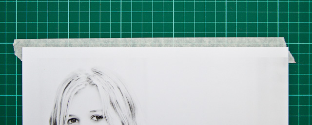

Fixing the print to the mount.
- Lay a piece of (masking) tape, sticky side up, on your mat.
- Offer up your print and half-stick it onto the tape.
- Offer up your mount and position it over the print.
- Lay the mount onto the print and tape, and press down firmly.
- Flip the mount over, and tape down the other three sides, starting with the side opposite to the one you just did.

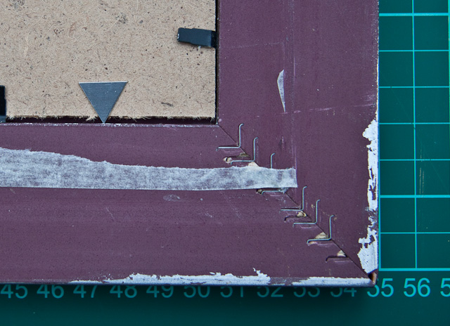

If you need to re-pin the backing board...
- Lay the triangular clip on the backing board.
I didn't need to do this for this example, as the metal bendy clips were in place, but this illustrates the point
- Using a pair of pliers, grip the frame and the clip, and push the clip into the wood. I find that masking tape on one jaw of the pliers prevents the frame being damaged.
- Once you're done, tape it all up again to keep the pins secure.

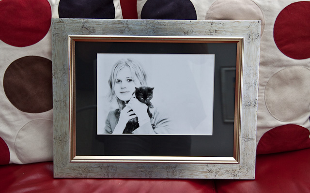

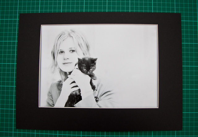

Admire over a cuppa
All finished and done. Bought this frame today from a charity shop for £3.99
This really is quite simple, and means that you don't need to crop your images to certain dimensions to fit into shop bought frames. It's also a great way to present your images relatively cheaply.

"and tape down the other three sides, starting with the side opposite to the one you just did"
I was told to tape only the top edge, to allow the print to expand up or down with temperature changes and not buckle.......old wives tale..??
excellent - and timely as I just started to print some of my favorite shots
one small question...
No, more to do with humidity and fibre based photographic papers, resin coated ones and more modern inkjet and dye-sub photographic papers should not suffer to the same degree so less important now.
Still suspect it is good practise though!
