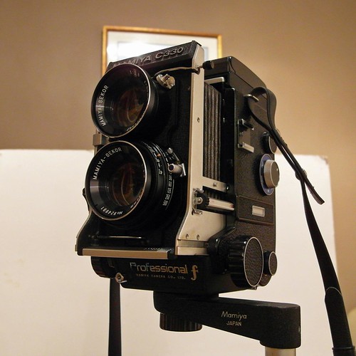

Been thinking about a c330.. cheaper than blad aswell! Not too big either, so good for handholding
It uses the same focussing mechanism of an RB67 so it can be a little fiddly at first.

@Andy will you stop putting pictures of that Mam 330 up :bat: it is seriously tempting and I mustn't get another MF Camera :LOL:
Go on, you know you want one. What difference will one more camera make?:naughty:
