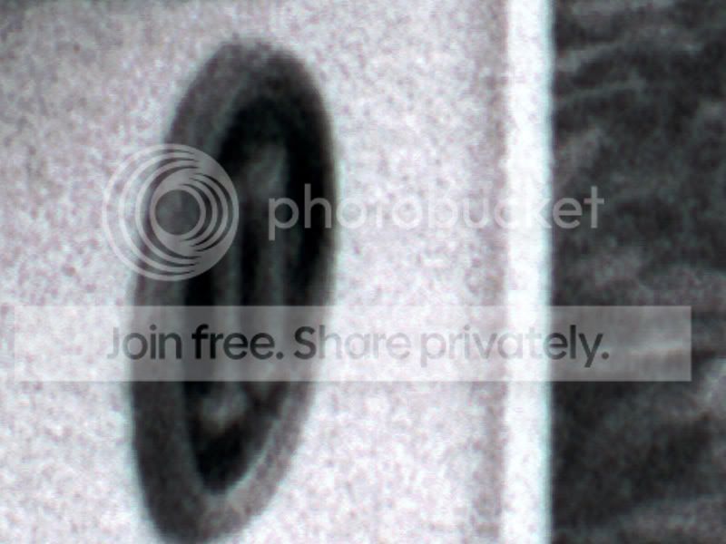

Scanned a 6x6cm Hasselblad negative at 11520 dpi which is just below the 12800 maximum resolution of the scanner, but there is a 4GB file limit so that was as high as I could go.
This produced a file with a size of 25358 x 25876 pixels which turned out to be 3.67GB. A bit slow to work with in Photoshop. and would have required a monitor of 30 feet square at a resolution of 72 dpi and would have produced a print of 85 inches square (almost 7 foot square) at a resolution of 300 dpi.
The 100% crop was taken from the area of the red box at the side of the door. Whilst grainy and lacking sharpness it is a very small part of the overall negative. The amount of detail and smooth graduation of tones which can be acheived at smaller enlargements from this resolution are simply mind blowing.
Impressive detail Ed, I've got a roll of Velvia in my newly acquired RZ67 that should be finished soon, it will be interesting to see the results as all my other MF stuff has been shot on either a pinhole or my old Agfa Clack.
One could argue that you're scanning noise at that resolution for that scanner. Flatbed scanners don't have much more than true 2400dpi optical resolution from what I've read and scanning with interpolated settings does not increase the level of captured detail. It could help you get a bigger print though.
If your scanning software supports "size reduction", you could scan at, say, 4800dpi with a size reduction of 2 and you'll get a file sizes for a 2400dpi scan but with the software averaging that with the 4800dpi in case you scanner has more true resolution above 2400dpi.

erm well the point was:- From "flatbed" advertising you think you are getting 12800dpi at best, but 2400dpi is about right. When you scan higher all you get is less pixel breakup, so large size photos don't look grainy....but then you can use de-noise programs to prevent this (grain) but the image is really turning into digital :(
