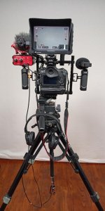

What we do and how we do it is significantly different. I'm using a Canon DSLR in a SmallRig cage, and my Rode mic is attached to the cage. The coiled cord threads through the cage to the mic connector on the camera, so the coiled version of the cable is stretched slightly and doesn't move around making noise. In retrospect, I probably could have bought a low end pro camcorder, for what I have invested in this rig.
Charley

this camcorder I have has in the handle (not included but bought seperately) has the xlr controls built in and the ports on the other sidea plus a led light at the front. earphones plug imto back of camcorder
Less to carry and assemble than thatone on your rig. .
As it is supposed to be the lighest 4K camcorder available it sits comfortably on my Manfroltto Befree live tripod.The built in ball tripod head save adjusting the legs for levelling up
on the tripod arm ia a wired remote for on/off and zoom only
