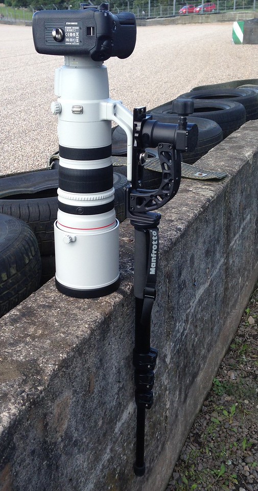

If it's a heavy set up then I can highly recommend the following, I have done a 12 hour trackside shoot with just a 10 minute break for lunch 'just'.
Basically:
MonoPod belt pouch - Don't use your normal belt that hold your trousers up, I went for a wide fabric belt that I wore slightly higher just for the pouch, which was a lot more comfortable.
On the head of the monopod I now have the ProMedia Tomahawk Head (don't listen to the video on that link unless you really have had enough of life itself) with the PX6 foot on the lens. very light, over engineered and really smooth action. Mounted straight onto the pod with no ball head, turned the lens collar 45 degrees so it was side mounted and the swivel is now up and down, put a tiny bit of tension on the ball race and it's good to go.
I know it's not the cheapest way BUT it works really well and will no doubt last a lot longer than I will need. Probably of no use to you but thought I would pass it on anyway.
