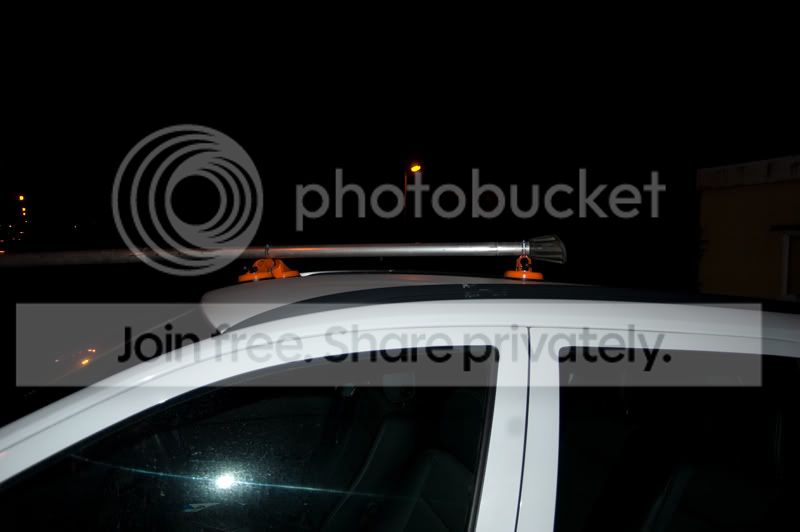

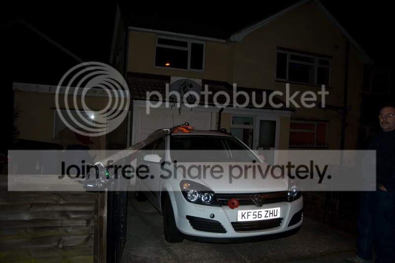

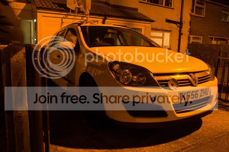

My DIY car rig
I've voiced my opinion before on glass/tile lifting suction cups so, I wont go into too much detail: Don't do it.
I can't see your photos of the rig as I'm sat behind a silly proxy at the mo, it sounds like it's pretty heavy though, just be carefull with it.
For those who wanted to see more examples, here's some of mine with a similar suction cup based rig:
Mitesh, tell me if I'm sticking my nose in where it's not welcome, but seeing as you said you bought the rig it looks like something odd is happening.
Are you aware that fastfilms are using your images with "copyright fastfilms" stamped on them on the page that you linked to?
