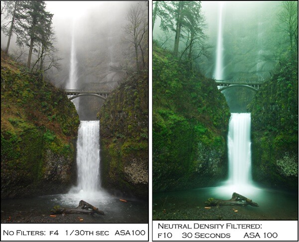

It reduces your the light by 10stops meaning you can capture a slow effect, mainly used for landscape photography. Found this online, not the best example but your see it gives the water a slower creamer look :)

That must be a pretty crap filter that they used, look at the colour cast!!
Looks more like they used a Welding Glass... There used to be a thread on here about using them somewhere...
