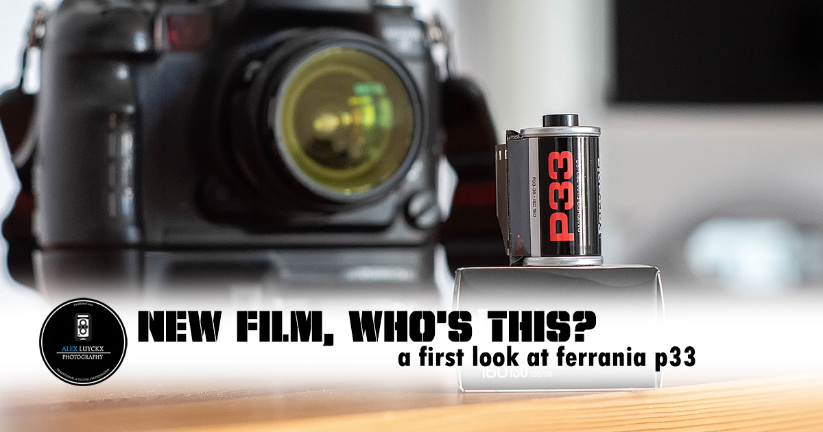

I had a reply on Mastodon from a guy in Canada called Alex Luyckx, who does a lot of reviewing and testing of films and developers. He wrote "Have them use the listed times for Ilford SFX 200, it seems to work with P33. Xtol Stock would be 7 minutes, 1+1 is 9. DD times Stock is 8.5. 9 Minutes for HC-110 B Hope this helps!"
This worried me a bit since:
Today I developed my Film Ferrania P33 film in Kodak HC-110 dilution B (1+31) for nominal 7 minutes 30 seconds (reduced to 6 minutes 22 seconds because of near continuous rotation in my Rondinax. I make a small partial rotation every second throughout the development time). I have images! The negatives are now dried and sleeved, and spending a day or so under a heavy book (probably not necessary because they sat pretty flat). To my extremely unskilled eye, they look OK. Definitely plenty of contrast.
So Alex was suggesting 9 minutes to my 7 minutes 30. I'm immediately wondering how I can tell if my negatives are under-developed. I found this advice from marcmarc on Photrio from 2010:
"If you have adequate shadow detail then your negs are properly exposed. What is adequate? That's your choice. Now for the highlights, the very unscientific way for checking them I picked up was to lay the negative on a white page with black printed lettering. You should be just barely able to make out the words in the dense parts of the negative. If you cannot, the neg is over developed; likewise if you can easily seen the words your neg is under developed."
I would take anything Alex Luyckx says about film, developers and testing, with a huge grain of salt. I think his results speak for him much more than his blog's wordy content. IMHO.
I would take everything Alex Luyckx says about film, developers and testing with a huge, huge grain of proverbial salt.
Interesting, any specific thing to point at? (EDIT: noting that the advice I'm quoting above is also from some random guy on t'internets, although it was corroborated by some other random guy, and Photrio folk often seem to know what they're about!)

I checked A. Lucky's blog here
And you can see an image of some Ferrania negatives hanging to dry. I don't know if these are the ones he used to produce his 'review' but if so, I stand by my point before: these are hopelessly overdeveloped and will scan poorly, especially on consumer equipment such as the v700 flatbed he's using.
