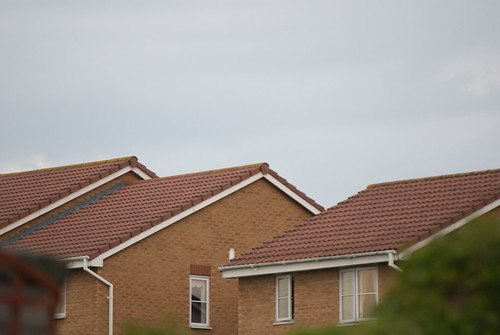

@Puddleduck shooting at that distance it seem "ok" I'm lacking some experience now...
Focus is point of roof in the centre house

OK...well IMHO shooting test charts close to a lenses minumum focus distance is flawed and stands a good chance of finding problems that don't exist, which is why I suggested the chimney shot.

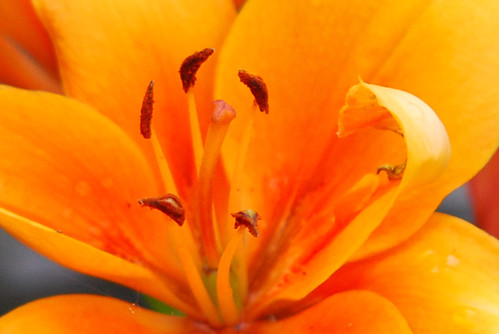

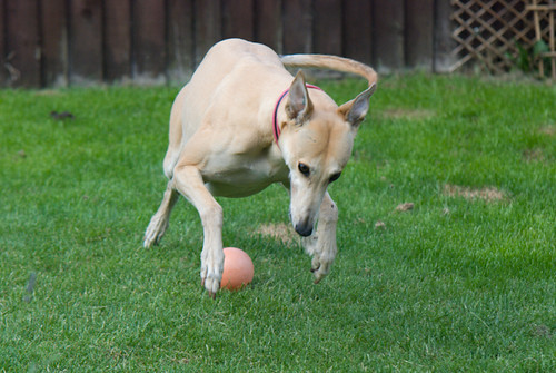

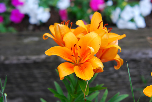

Had another play this afternoon.... Maybe i just cant take photos.... I'm @ the Renault World Series this weekend i'll see how i get on!
Crop
Thanks very much for the advice
Simon
when taking pictures like that of the dog, try it in f6 and f8, i done some portraits of my girlfriend in f8 and they turned out mega sharp!
