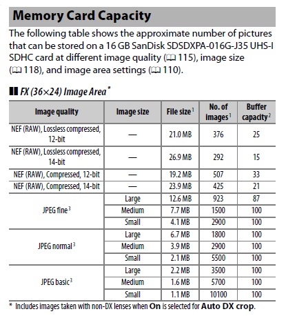

Any input on memory cards?
From the Manual ----
Do you shoot RAW? If so, how many do you get on a 16GB card?
I very rarely go over 300 photos on a day out, so the 16gb cards are fine for me shooting in RAW. I'm getting the same usage I would have thought as the link Barry shown in his post.
Just a couple more questions.....
How many RAW files can a 16 or 32GB card hold? I'll need to buy a number of cards, but would rather have mutiples of smaller cards as opposed to large cards in case of failure, even though it does have a dual card slot.....
Also, what speed card should I be getting? I've seen the Sandisk Extreme Pro (95MB/s), but I won't be machine gunning, so I don't think I need them to be super fast......Would I notice these write speeds when transferring to the computer too?
Thanks in advance.
Do the math. Average file size 30-35mb with RAW on the D750. I use 32GB Sandisk Pro 95mb/s, one as RAW in slot 1, one as jpeg backup in slot 2. The camera's buffer size is the limiting factor to your continuous/burst mode rather than the card. The speed of the card will help clear the buffer faster but even with a fast card your FPS drops a lot when your camera buffer's full. Even with the 95mb/s cards I would say frame rate drops to 1-2 FPS.
Thanks, I wasn't sure of the RAW filesize on the D750.....I have the info anyway after @chuckles post

Seems I over estimated anyway lol. Just checked several of my RAW's shot at 14bit lossless and they range from 27-30mb.
