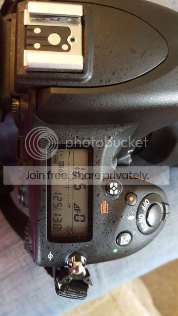

My 24-120 has just arrived and I can't change the aperture, I'm probably making some noob mistake.
On the display on the top where it displays the first number there's a triangle then f0.
On the sliders on the side it's set to M/A VR off and active.
It usually displays that when you don't have a CPU lens attached (i.e. a non-cpu lens is attached)... have you tried turning it (the camera) off, taking the lens off then re-fitting it?

Looks like a dodge connection/the lens not communicating with the lens. Sorry for the patronising question but are you sure you've locked the lens into the mount fully? Have you tried other lenses on the D750?

Thanks, yes it was a noob mistake, I mustn't have put it on correctly, I took it off and put it back on and it's ok, it's much stiffer to turn than my d5300 lenses were, I noticed when I put my 35mm dx lens on it almost grinds until it clicks but I thought maybe because it's the wrong lens.
It might be the 'weather sealing'. These lenses have a rubber gasket at the lens mount.
