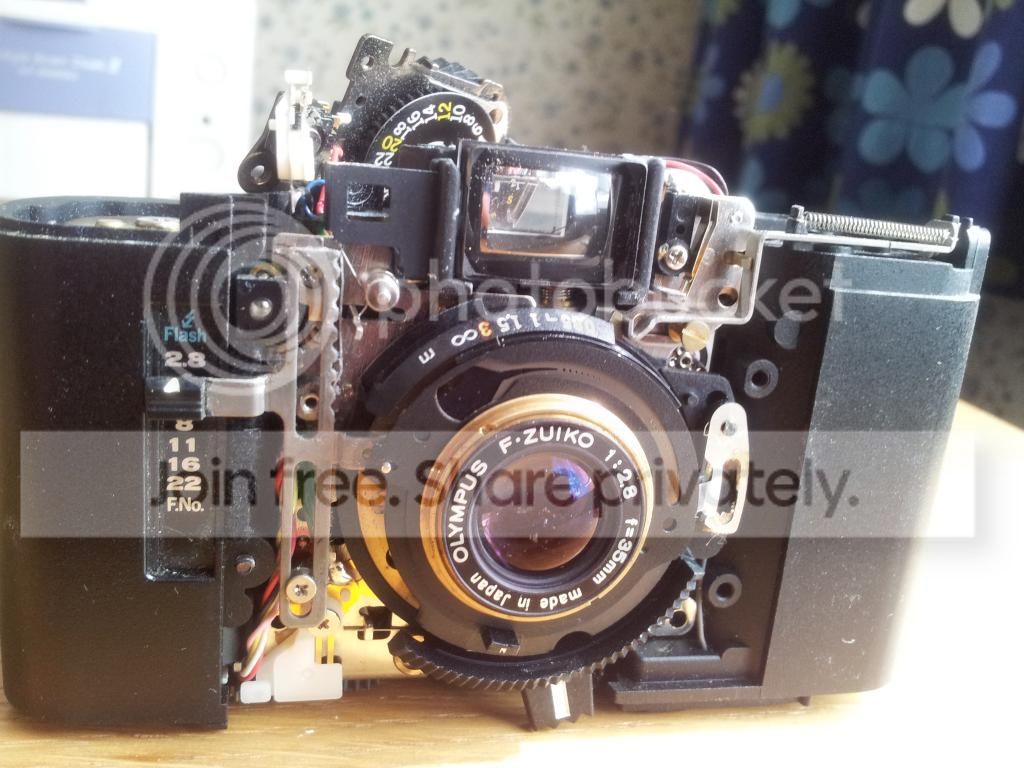

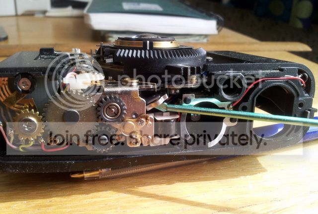

I fished my u/s model out of the bin to take some phone photos of its insides in case you opt for a more conservative approach. Firstly the good news, here's the view you get by just removing the bottom:
The green cocktail stick is holding up the armature on an electromagnet, which I assume operates the shutter. It would be worth wiping the armature and magnet pole piece faces with a cloth dampened with lighter fluid. Doing that to my Canon A1 fixed a non firing shutter. This operation requires minimal disassembly and a low risk of breaking anything.
Here's the bad news, the front view:
I've no idea where you would start removing pieces to investigate. Once again, best of luck
