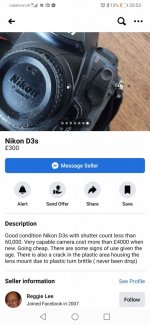

Screenshot_20230801_205342_com.facebook.katana.jpgI think as long as you're sensible, do the right research and consider general condition then you should be ok (i.e don't get fed BS like the D3S being made from brittle plastic ;))
