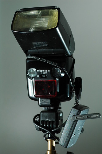

Hi Guys, Ive got a couple of SB28's I would like to fire off camera from a D300, am I right in thinking that the Elinchrom Skyports are the next best thing from PW's and a big step up from eBay efforts?
I'll need to pick up a set (trigger and receiver) and an extra receiver right?
Are there any other cables Im going to need to hook them up to my strobes?
How do the receivers attach to the strobes, or do you just leave them hanging/tape them to a tripod?
Thanks for your help

I'm here :lol: :D
Depending on how many SB's you have depends on how many receivers you need. I have three flashes so I have three receivers.
The cable you would need to hook up the receiver to the flash is this one. Also while your on that site you can also buy the Skyports from there as well. Here and here.
The receivers come with a strap so I just hook it round the flash head like this
Hope that has helped you out
Thanks for that cherryrig.
I have 2 SB28's so will I need to get 2 of those cables or does one come with the receiver/transmitter set?
How would I attach my strobes to a tripod and/or lightstand?
In that photo I posted I use these. It has a hot shoe flash mount on the top and can tilt up and down then on the bottom it has a 1/4" thread on the bottom (normall tripod and lightstand mount size)
That's great, thanks.
So with the cable, will I need to buy one extra or another 2?
Depending on the amount of flash you have depends on the amount of cables you need to buy. Basically the same for the receivers as the Uni kit does not come with one of those cables.
I have three flashes which means I have three receivers and three cables.
Your transmitter does not need one as it just fits on the hot shoe.
Hope thats helps you out?
