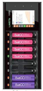

Oh this one looks pretty cool....
LIMETA 8-Slot Smart Rechargeable Battery
Link
