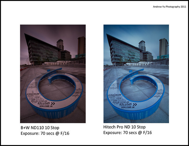

Well Formatt filters have launched their new 10 stop filter which replaces their old one which did suffer from a magenta colour cast, the old one was reviewed @ http://blog.robertstrachan.com/archives/844/lee-big-stopper-hitech-10-stop-nd-filter-review/
Getting hold of the Lee "Big Stopper" seems to be quite hard and short in supply and I wanted to invest in a slot in filter because I spent alot of time fiddling with the B+W screw in filter and when the light conditions started to fail, using live view to try and "burn" through the 10 stop was next to impossible.
After reading Robert Stratchan's blog, I decided to go for it and purchase the 10 stop Lee fitting filter from Formatt filters (I have to say, the lady at Formatt was very friendly and helpful) at a cost of £60 + VAT + a small charge for delivery.
This morning I decided to take it for a trial run in an overcast Manchester area with a few spots of rain at the same time.
First impressions of this 10 stop, well, it comes with a pouch, paper wrap, an exposure chart for calculating shutter speeds and the actual filter itself which is made out of resin, but unlike its predecessor, this 10 stop comes with a rubber gasket which should prevent light leakage.
After comparing it to my current B+W 10 stop, the colour cast is no longer magenta but blue which I find is easier to remove in post processing, ( I just bump up the WB Kelvin and add a tint of red where required )
It appears the Lee Big Stopper suffers from blue colour casting as well from the other reviews on the net.
Overall, I am happy with this purchase, it certainly doesn't break the bank and it has made my life easier.
Wow! The colour casts on both of those are way worse than I experienced with my B&W ND110 (now sadly defunct) and my old Hitech. I used Auto WB when I tested, what did you use for WB?

Wow, that's quite a difference. Didn't realise the B+W gives such a cast, and it's one of the most recommended! I might invest in one soon, funds permitted. Have you tested any others that you can compare to, for IQ and colour cast?

Yep my B+W always gave a magenta cast.

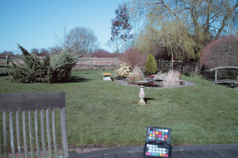

The test needs to be done with a fixed white balance - eg sun, cloudy, shade setting.
My B+W was nowhere near that bad, but bad enough for me to swap to a LightCraftWorkshop 500ND which is the most neutral I've tried (fractionally bluish, very similar to the Lee Big Stopper).
Edit: these very dark NDs are never perfectly neutral, and they vary slighty in both tint and density batch to batch.
I have managed to finish the review now that the rain has halted for a wee while. The results were quite good. The Hitech filter was just as good as the Big stopper on most shots. The full review can be read here.

It would be nice to see shots without the filter and white balance fixed - either custom, or daylight or whatever, but fixed. Then with the Lee and the Hitech, exposure adjusted to match the density of the unfiltered shot.
That way we could see the colour, and check the density by comparing exposure times, which would be brilliant :thumbs:
OK, how would you want me to adjust the density and how would you measure it?
By the Blue channel in the histogram which is the channel furthest to the right or trying to match by eye even though the blue cast makes it difficult.

No both filters are not neutral and its blue and wont be usable (to me anyway) without setting a custom white balance. It's not as blue as my Big Stopper though. I dont really see this as a big issue though as long as the cast is easily removed thats all I care about. Both 10 stoppers do an admirable job once a custom WB is set.
I can upload 3 individual images all set to daylight white balance (probably tomorrow night now) , all it will show is that both 10 stoppers are blue though:)
So to answer your question it's not neutral and its about 9.5 stops.:thumbs:

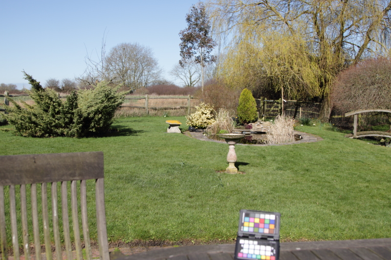

Inspired by this thread I thought I’d do a quick test of my B+W filters as I knew I didn’t have casts as extreme as others B+W filters.
I took an unfiltered photo to use as a reference then added my filters.
I’d previously tested my 10 stop and I think it is around a 10.66 filter so I adjusted my timings for that, also looking at these photos I think my 6 stop is probably a little less maybe 5.66 stop?
These photos are taken straight from adobe raw all that has been done is they have all had their exposure adjusted by -.5 stop and then cropped.
As you can see my 10 stop has a blue cast and the 6 stop is very slightly warmer than the original but to be honest I’m pretty happy with the result, these casts are very easy to correct.

Interesting tests Dale :)
Have you done anything to the colour? How was it set in shooting/processing? The standard B+W is notoriously warm, as mine was, but yours has gone the other way. Which filter is it exactly? Is it the new (very expensive) multi-coated version?
I've done nothing at all to the colour, all I did was open in camera raw and apply -.5 stop exposure to them all.
The lighting was side lit from a window with a white reflector on the left with +1 stop of exposure compensation.
The 10 stop is the new multi coated version the 6 stop is the normal uncoated version.
