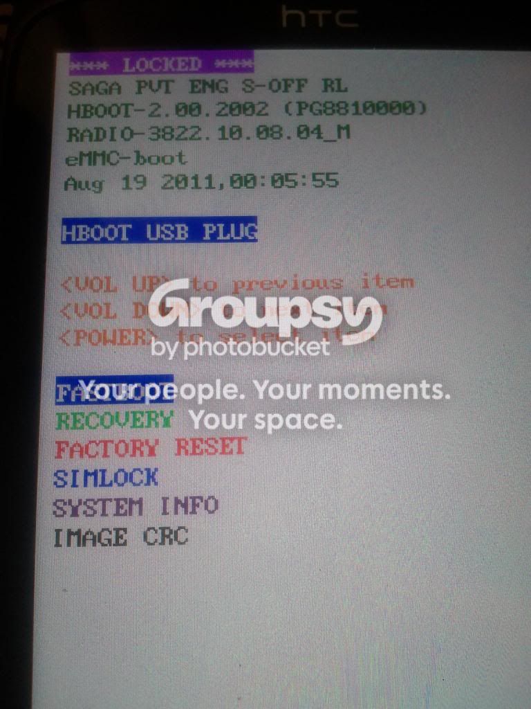

One thing that is still confusing me is the issue of the HBOOT version. Do i need to downgrade it if the version on my phone is 2.00
The instructions on cyanogenmod website (http://wiki.cyanogenmod.org/w/Install_CM_for_saga) says that i have to have S-OFF and i have to use a tool called "Revolutionary". The problem is that this tool will only support versions 0.98.0000, 0.98.0002 but my version is different (see attached image).

You will need to downgrade the HBOOT if you want to obtain root and custom recovery using the "revolutionary" method.
See the link below on how to get HBOOT to 0.98
http://androidforums.com/desire-s-all-things-root/730501-how-downgrade-desire-s-hboot-98-a.html
After that revolutionary will install clockwordmod recovery and you will be able to do a nandroid back up before you flash a custom ROM.

Thanks for your help guys. I managed to update it using the instructions from here http://believeinmiraclesx.wordpress.com/2013/03/26/install-cyanogenmod-10-on-htc-desire-s-hboot-2-02/
