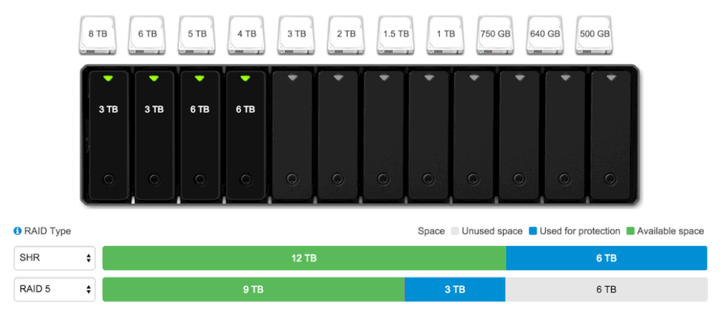

  1. Swap out 2 of the 3TB drives for 6TB drives @ £200 each. This should increase the NAS storage capacity from 9TB to 12TB.

Not sure if this is telling me my DS413 is ready to run with 6TB drives. If so, then option might be my current preferred option, but I'm open to suggestions.

Very quickly, from what you said you are running raid 5.
Don't know if you can run the 6tb drives, and how much space have you used ?
If it is RAID5 then the 6TB drives will not give you any extra as each element of the RAID is the size of the smallest and any extra is ignored.
I'm using Synology Hybrid RAID (SHR) rather than RAID 5 and currently I've less than 100GB space left.
Adding 2 x 6TB drives would give me an extra 3TB according to their capacity calculator...
