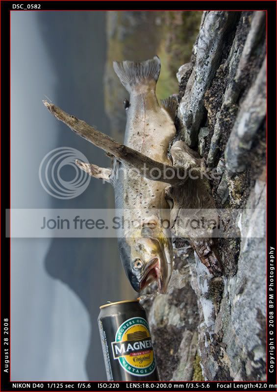

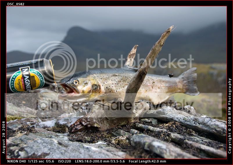

Just tried the EBS default and got this result:
Couple of things I noticed - I blanked all the options except for name and company name but instead of a blank space where shutter speed should be I get 'undefined' and against Lens I get a '?'. Is this normal?
Also I noticed that the focal length is cut off, but it is a narrow picture....
Great work by the way.
Thanks for clearing that up.(y)

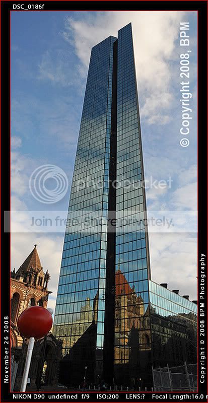

The lens name is not part of the standard exif data so this only works with RAW files. If you select multi-line it does word wrap the exif data so that it fits. I am looking into the EXIF data more as we go on because the next thing I am writing is an EXIF data analyser which will take your EXIF data and tell you everything about the picture, camera and lens (things like how many pictures the camera has taken etc). With the information I gain from doing this I will come back to this script and improve it. If you look at the EBS directory there should be a file called "last EXIF" this is a text file that contains all your EXIF data (you can turn production of this file on and off with the EDITOR). When I start I will be asking for people to send me as many of these as possible.
Try running it with a RAW file and if you still have any probs then just email me and we can see why. There were several modifications made to the EXIF part previously when certain camera/lens combos caused abnormalities. But most importantly the script can only display what is actually in the data.

Okay, tried it with a RAW file and it did pick up all the data, but just to confirm, if I'm running this on jpegs my options are to manually enter this sort of data, or else settle for 'undefined' and/or question marks where data should be?
I rotated the same pic 180 degrees to see if there was the same issue with lack of space for the data, and sure enough there was - so I'm keen to hear how I turn on this word-wrap option.

Sent you email with my last EXIF data file and the problematic jpg with partial EXIF so you can sort the EXIF undefined error!
Everything else in version 2 (downloaded 30 mins ago) seems to be working fine on elements 7 :)
