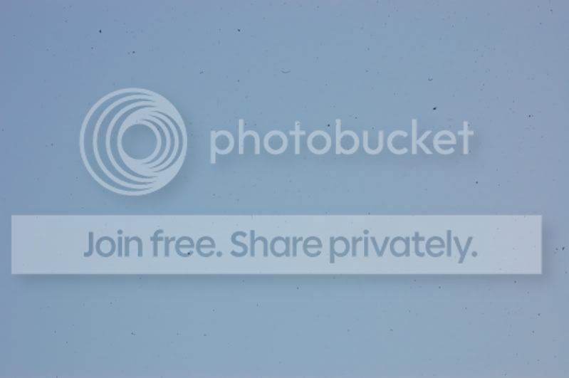

Ahh I see, good job I did not just go and do it there is quite alot of sticky dust on my sensor and I do not have a blower or any of them brush things to get it off. Help?

Dirtiest sensor ever? had it over a year and never cleaned it.

I have tried brushing it with a soft brush, turning it upside down and blowing inside, I ordered a very cheap blower but I believe the dust is sticky!
