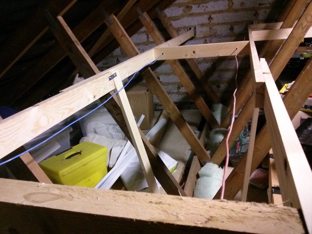

Hi All,

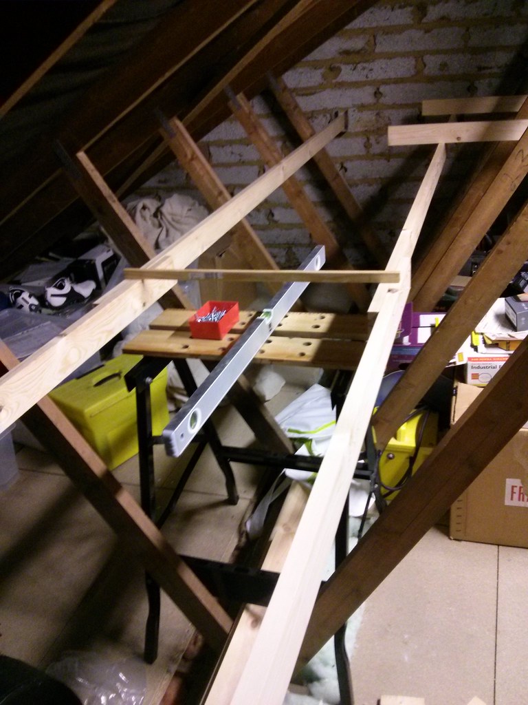

I have decided to create a model train set up in my loft.
This is going to be done properly, having read up on how to do it on a model train forum.
I'm only at the very early stages at the moment.
My stages are going to be something like the following:
1. Install Joist Hangers
2. Install 3"x1" timber battens between joist hangers and any required noggins
3. Run power supply cabling between timber battens.
4. Install Plywood over the Battens
5. Install Corkboard over the Plywood (to dampen the train noise)
6. plan and lay out track
7. Drill holes in Plywood for "Dropper Wires" (so each piece of track has its own solidly connected power supply)
8. Install Track with Dropper wires
9. Begin installing scenery stuff, starting with "Ballast"
My loft is split in to 3 main bits, the middle part being the highest standing area as it follows the apex of the roof.
The the plan is to have the trains going around the middle 3rd of the loft at a sensible sitting height, so that when one enters the loft, they enter into the middle of the train area (difficult to explain).

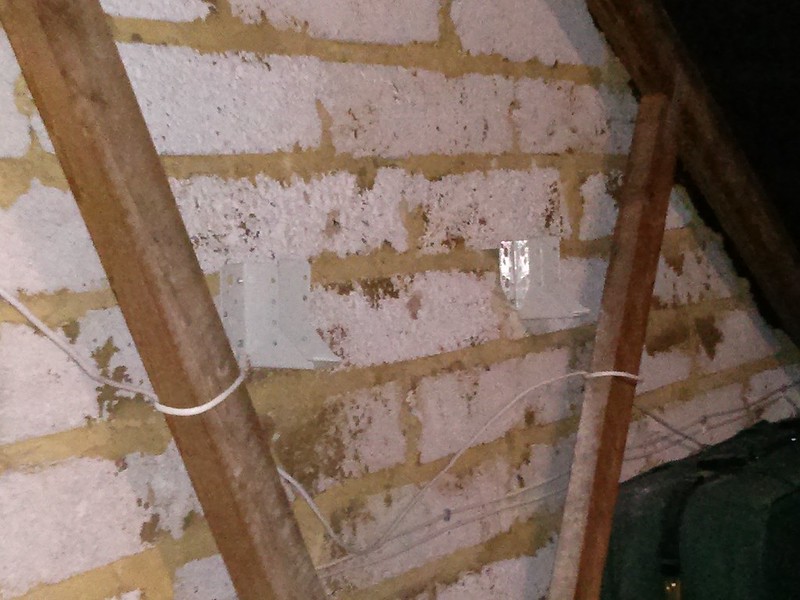

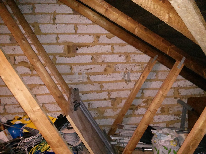

Because there's a lot of stuff in the loft, I didn't want to add any major extra weight to the joists, so I'm mounting the frame by use of joist hangers on the walls to support the majority of weight.

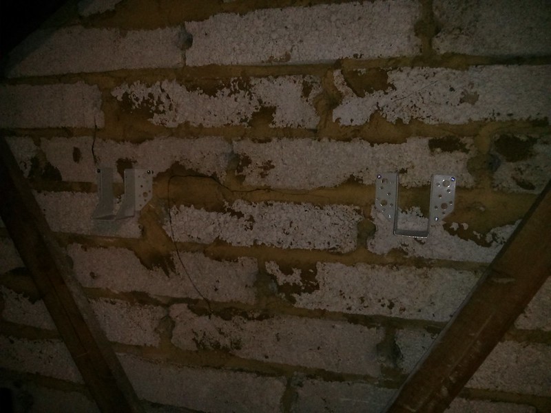

So Far, all I've done is stage 1 as Payday hasn't happened yet and they were quite cheap. I've mounted them about 0.85m high above the loft floorboards
Only have some photos taken with my phone at the moment and they're not that exciting as they're just joist hangers!
Stage 1 Photos:
Joist Hangers 2 by Mr_Si, on Flickr
Joist Hangers 1 by Mr_Si, on Flickr
Joist Hangers 3 by Mr_Si, on Flickr
Joist Hangers 4 by Mr_Si, on Flickr
To be continued...
