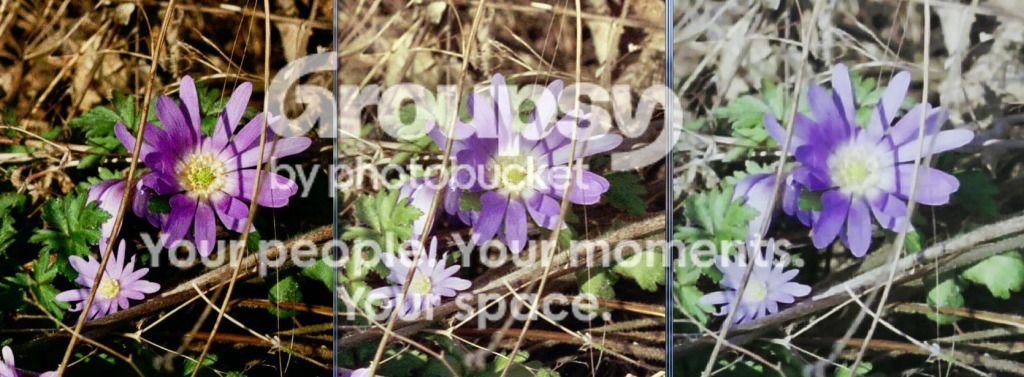

Screen grab of 'zoomed in' comparison samples (once again, as near as I could get size-wise), from left to right: Noritsu; Epson V600; Budget USB scanner:
Well, as you might expect, it appears that you get what you pay for when it comes to scanning 35mm film. However, if I darken the Epson scan of the flowers in Photoshop there is some more detail there in that image, so a bit of post-scan processing can soon sort that. The budget 5mb USB scanner is small and portable, it powers itself from a computer USB port and saves the images to a SD memory card. So you can take it along with a laptop computer and scan negatives at a relative/friend’s house fairly quickly and without much bother. Just learn how to use it, press a button and get the results displayed on its own mini LCD screen and saved to the SD card.
