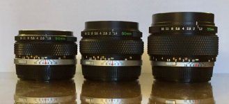

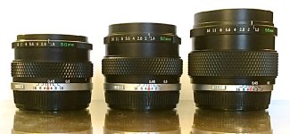

One thing to consider if you are going for a light weight outfit is the size and weight, 170g for the 50mm f1.8, 230g for the 50mm f1.4 and 310g for the 55mm f1.2.
Edited to add: and racked out to closest focus of 0.45m
