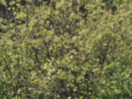

Nikon AF-S 70-300mm f/4.5-5.6 VR: Having recently acquired this lens I have only had the chance to use it a couple of times. First was in the Forest of Dean on Saturday. Taking some shots of mountain bikers on the downhill tracks this lens was superb and sharp and the out of focus bokeh was very pleasing. I used VR for all of my shots as the light under the trees was pretty dull - plus it was cloudy.
Anyway, I used the lens again today shooting (pictures not guns!) birds and insects and I've noticed that the bokeh in a fair few of the shots is pretty awful. Same camera, the only difference being this time I had VR turned OFF as I was using a tripod.

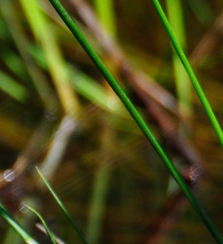

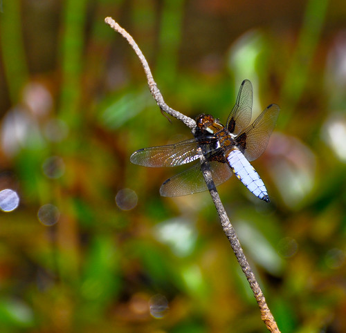

Here's what the bokeh looks like: (click for larger)
Now I can definitely see diagonal lines running bottom-left to top-right in the bokeh areas of these images.
All shots were wide open at there respective focal lengths (so f/5.6 at 300mm).
I'm aware that VR can effect the bokeh, but only when it is turned on. So what is causing this? :shrug:
You seem to be getting some odd effects form the lens. Is there any marking on the elements that you can see?
I never noticed effects like this when I had a 70-300mm VR, but then I didn't really take any similar pictures to the ones you posted.
Hopefully someone will pop up with an explanation, should there be one.
No, there doesn't seem to be any marks or scratches of any kind on the front or rear elements. I've had a good look around and it seems optically sound (to my eyes anyway).
I was wondering perhaps if the VR did not settle properly when I turned the VR off. VR includes a glass element that moves so is it possible that this VR glass element didn't sit back into it's default position when I turned VR off? :thinking:

Looks verymuch like interference patterns, which you get when you use gratings. However, these are most likley induced by the edge of the apeture blades.
Putting 2 and 2 together to make 5... perhaps the result is a combination of the small interfeerence fringes creating by the apeture blades creating Moire as the light passes into the sensor. Would be interesting to put that lens on one of my Kodak's which doesnt have an anti-aliasing filter, or a film camera
optically, to get Moire, light need to pass through 2 fairly regular patterns - and in this instance we have 2 regular patterns - the geometry of the photosites on the sensor, and the apeture blades

Did anyone actually bother to read that the guy took this images with VR turned OFF?
If the lens is wearing a filter, I'd like to see it taken off and some more tests done.

I'm not seeing anything wrong with the third of the three images posted. The Bokeh isn't particularly attractive, but it's purely down to the linear nature of some of those background stalks and the distance from the subject to the background.

Certainly it's a fact that any lens under certain conditions can produce 'donut' OOF specular highlights. If this is a regular problem with this VR lens I'd want it checking out, but as an occasional problem I wouldn't be worrying about it unduly at all.

After reading through the thread, I'm leaning towards the filter. There is differences between filters (obviously or they would all be the same price;)), and having a cheap one on a big zoom lens can show up the defects at maximum zoom of the filter. I had Jacobs/Cokin Polarizer on a Sigma 70-300mm and the camera was unable to focus at 200-300mm, :eek: and the image in the viewfinder was distorted. More extreme than what Basket Case has had, but it is an example of the Filter affecting the image.
Sounds like something very wrong with that filter!
Everything I'm seeing here and elsewhere (and dragging my ass through the effin' mire that is DPReview is going 'above and beyond' IMO) indicates that it's a problem associated with fast-ish OEM zooms in the 70-300mm/100-300mm range or longer...
