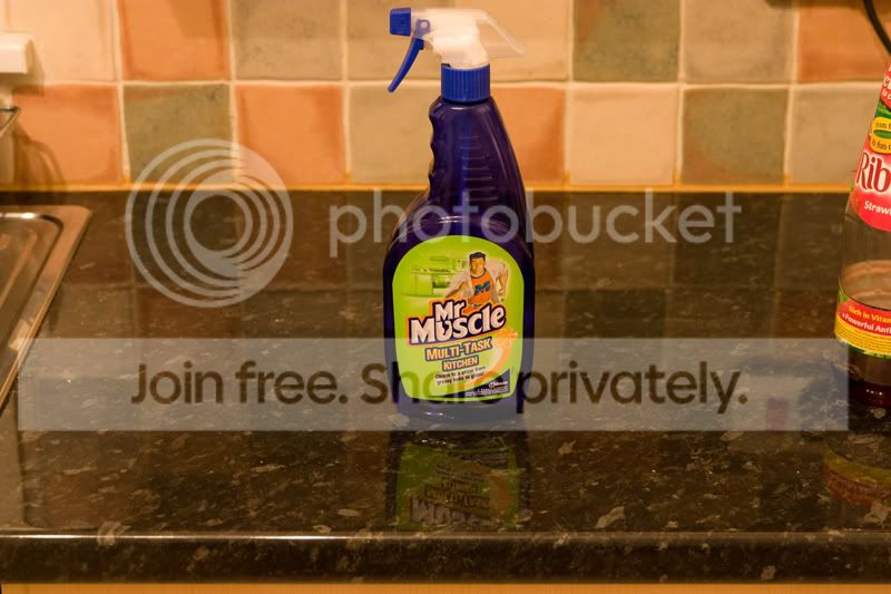

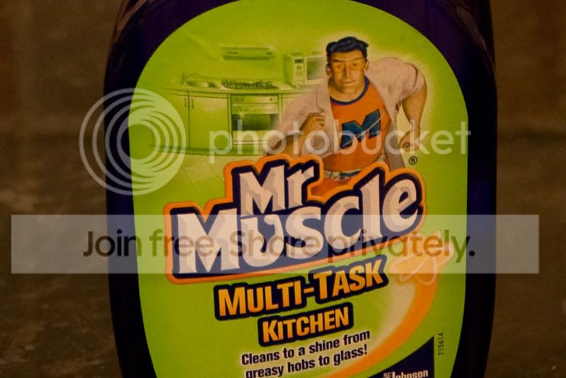

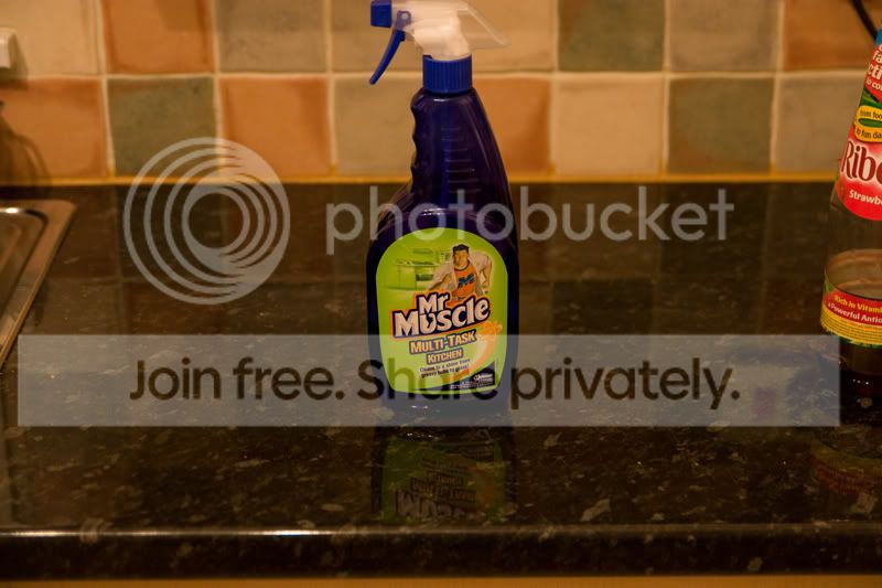

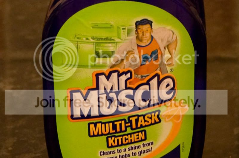

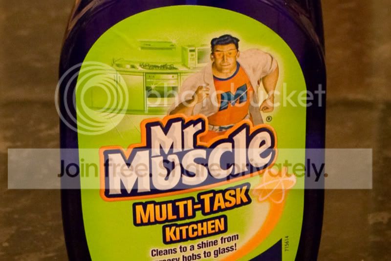

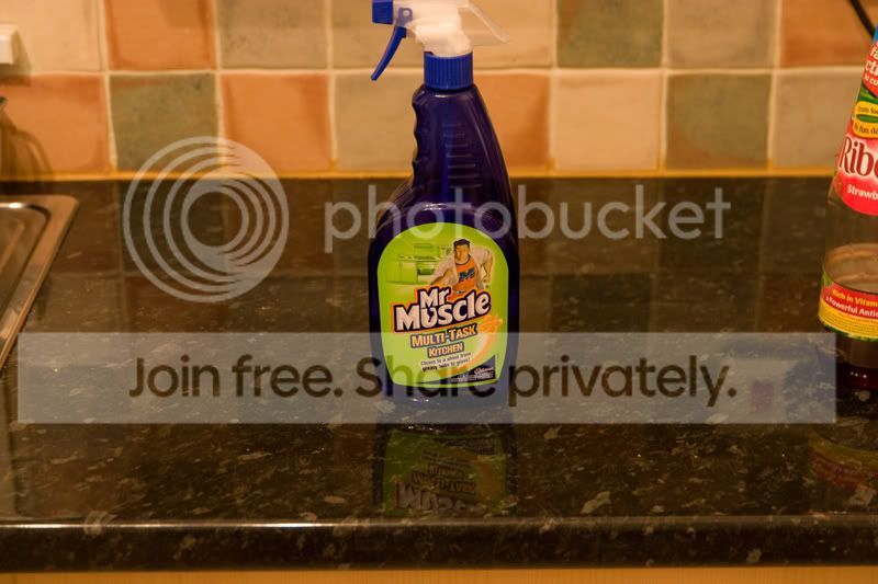

Right, further testing as requested. In the bathroom this time with a bottle of shampoo as a subject. My daughter's of course just to keep it consistent. Hand held again with the VC turned off and flash used.
50mm @ f2.8
17mm @ f2.8
50mm @ f5.6
17mm @ f5.6
50mm @ f9
17mm @ f9
I have to admit the lighting on these isn't the best.
hmm, the focusing looks off with the f/2.8 shots?
Can you possibly try a few shots with VC turned on?
I'd like to see what shutter speeds you can can achieve with VC.
Oh, are you using onboard flash or a dedicated flashgun?
As I am not a Nikon user I'm not sure if the D300 has an oboard flash?

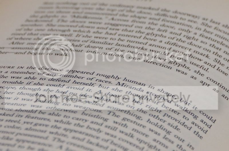

Hmmm. May not be as bad as they look on the LCD.
These are straight off the camera, no pp, just resizing.
All 3 are handheld with VC on.

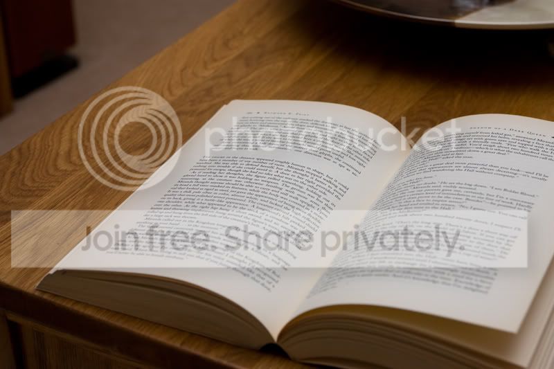

430EXII used (bounce flash from a ceiling 7ft above the book), only one small lamp in the corner of the room. All at 50mm.
1/200 @ ISO400
2.8
100% crop.
4
100% crop
5.6
100% crop

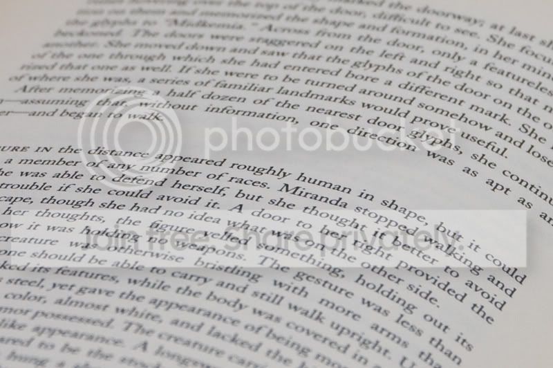

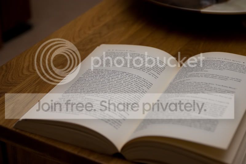

Ok some more.
All handheld, no flash, no pp, VC was on.
ISO800 (so on a 450 = noise :()
2.8 1/30s
100%
4 1/15s
100%
5.6 1/8s
100%
Am I being too fussy :shrug:
I am wondering if becuase I am still a relative newbie at photography if any issues could be compounded by technique and lack of experience :shrug:
They look good to me jnO.

OK, my shots are up now. I'm pleased with the results at f5.6 but f2.8 is very soft and f4 isn't much better.
I'm impressed with the VC because at f5.6 I was down to a shutter speed of 1/15th and there is no noticable shake and I don't have a steady had at all.

Its great to see how well its coming out with the smaller aperture from a hand shot. Though I am a bit shocked at how quickly it falls off when you open it up a bit.
I agree with the VC statement. It is impressive, I went down (as pictured above) to 1/8th :eek:
When I get my lens and attach it to my D300 I'll have a go at replicating your test... for comparison. How much have you zoomed in?

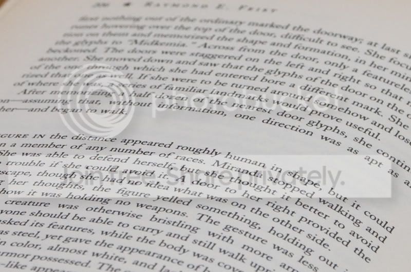

The last 3 samples I posted were all 100% crops from an image that started looking like this one.

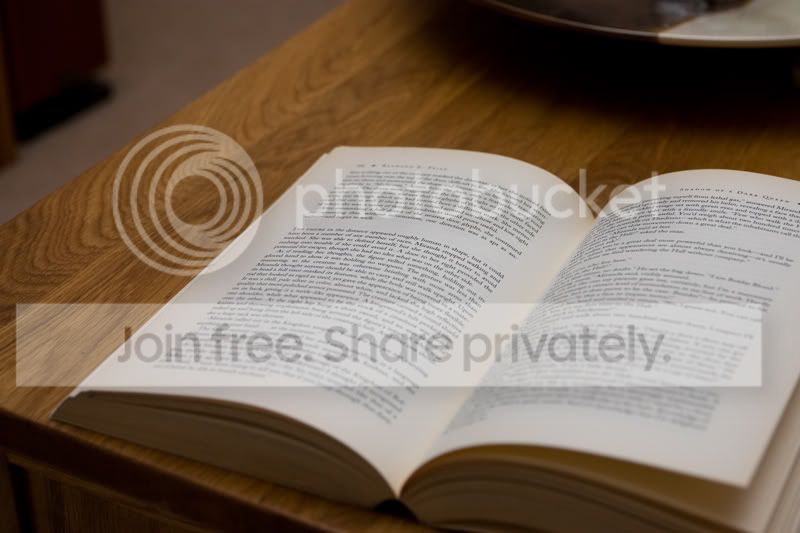

Right, final test for tonight before I go to bed.
Same shot as above but this time the focal length has changed from 50mm to 31mm. Again hand held, ISO800, no flash, 100% crop and focus on the 400F. Shutter speed went down to 1/15th again at f5.6
I think there is a vast improvement at 31mm at f2.8 than there is at 50mm but at f5.6 it seems a lot sharper at 50mm than it is at 31mm. Weird!!
31mm f2.8 1/60th
31mm f4 1/30th
31mm f5.6 1/15th
Just to confirm did you play with AF fine tune to tweak it? I've had 'soft lenses' wide open that needed a bit of tweaking to get them a lot sharper!
