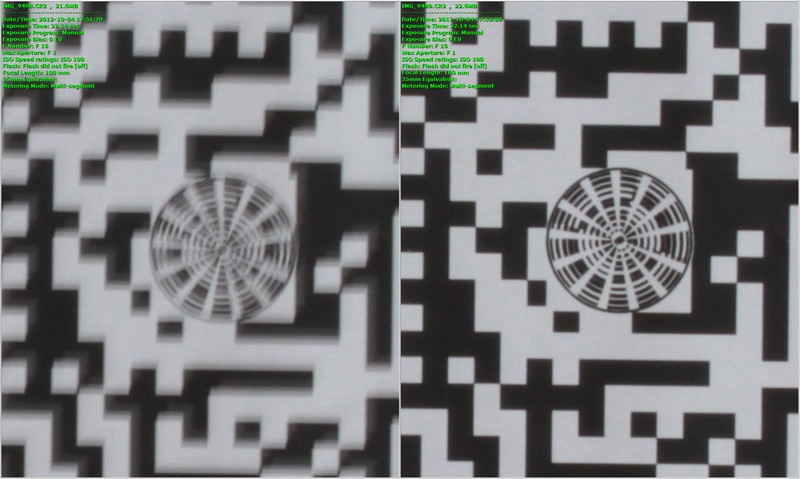

That piece by Thom Hogan is often quoted, and years old now. More significantly, he shows no pictorial evidence of this theory, and I've not seen anything even vaguely convincing from any other source. Furthermore, I've tried to recreate this alleged problem myself (using Canon) without success.
There are dozens and dozens of reports about having VR/OS/VC switched off when on a tripod.
Echoes of uv filter/no uv filter me thinks........
And, just like that debate, a proper experiment provides the proof.
100-400 22s exposures. IS on vs IS off. QED.
I've got results from the same test with the 24-105 that show no difference.
