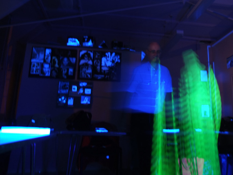

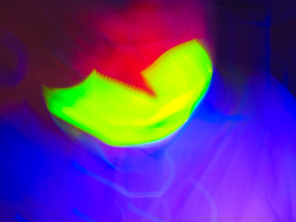

Talking of focus, Souldeep what do you make of these shots? The first is absolutely the first shot I took on receiving the X10 back from Fuji on Tuesday. It was taken to check the focus which was my main concern. The second I took immediately after (all OK), but haven't been able to repeat the anomalies of the first. It's obviously down to the flash I had to use, but what's gone on? Forget orbs, I started looking for spooks!
DSCF9449 by peter_garbutt, on Flickr
DSCF9450 by peter_garbutt, on Flickr
Isn't there a goulish raised hand on the LHS, ready to strike me, and isn't the bigger blob on the right, part of a woman's head showing the line twixt head and hair? Or am I not taking enough water with it?

First shot looks like classic camera shake - maybe the reflection of the flash painting in the picture. But looks more like a person walking in front as an abstract but you'd know that... :thinking: very fitting though... exactly what I was up to in tonight's session. I haven't been posting from each weeks session but as the subjects are so linked here's a few on the same tip. Some are very abstract as I was playing around a bit more than the lecturer asked for - I've never been any good with rules :bonk:

Thank God for that! This tiny cottage dates from about the civil war we think, and creaks - I've been checking under the bed every night since!
If you let us all know how you create these effects, maybe I could work out what went on in my shot. I can see the camera shake (by mistake, the flash was on Slow Synchro), but it appears solely in the vertical plane as far as I can see, whilst the effect is all over the place. Also there are no highly reflective surfaces (other than some shiny book jacket covers) anywhere close. You sure I can sleep easy?!

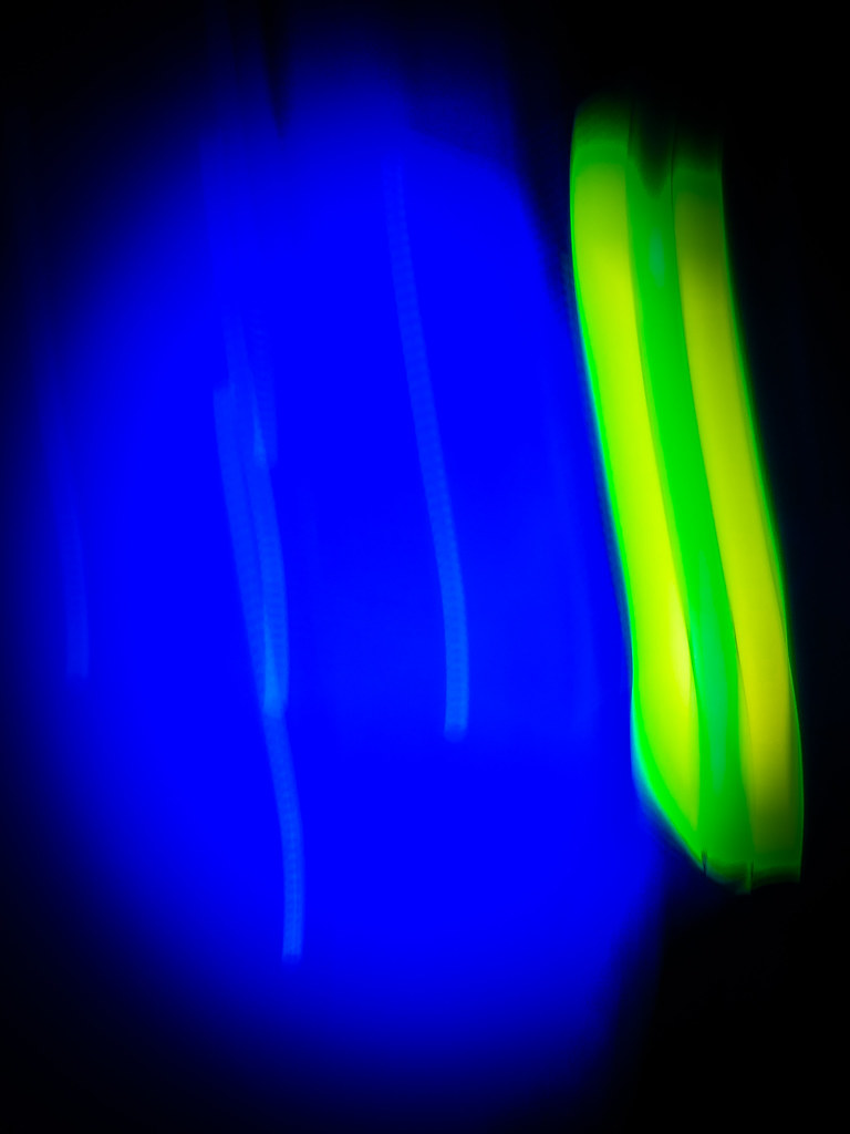

All I was doing was playing with shutter priority mode last night. Max ISO was 400 but most shot ISO 100. Shutter speed ranging from 1/2s to 2s.
It does appear you've had a few strange occurrences with your X10... it may not be your house, but rather your X10 that is haunted! I'd pop it in the cupboard, door firmly shut, each each night so you can sleep easy. Make sure you lock the cupboard though - to awake to a flashing X10 floating above your bed is enough to send anyone to an early grave ;-) Talking of apparitions...
Yep its blurry - was hand-held photography last night but did think this shot made the lecturer look like he was facing off against a spectral apparition!
Golly, you have posted some weird and oddly attractive effects. That last shot really does look like a man confronted with 'ectoplasm' - he seems to be happy enough about it though!
Pete's first shot has a 3.1s exposure (can view metadata on Flickr)
My guess is the flash went off and Pete waved the camera around not expecting the exposure to still be taking place.

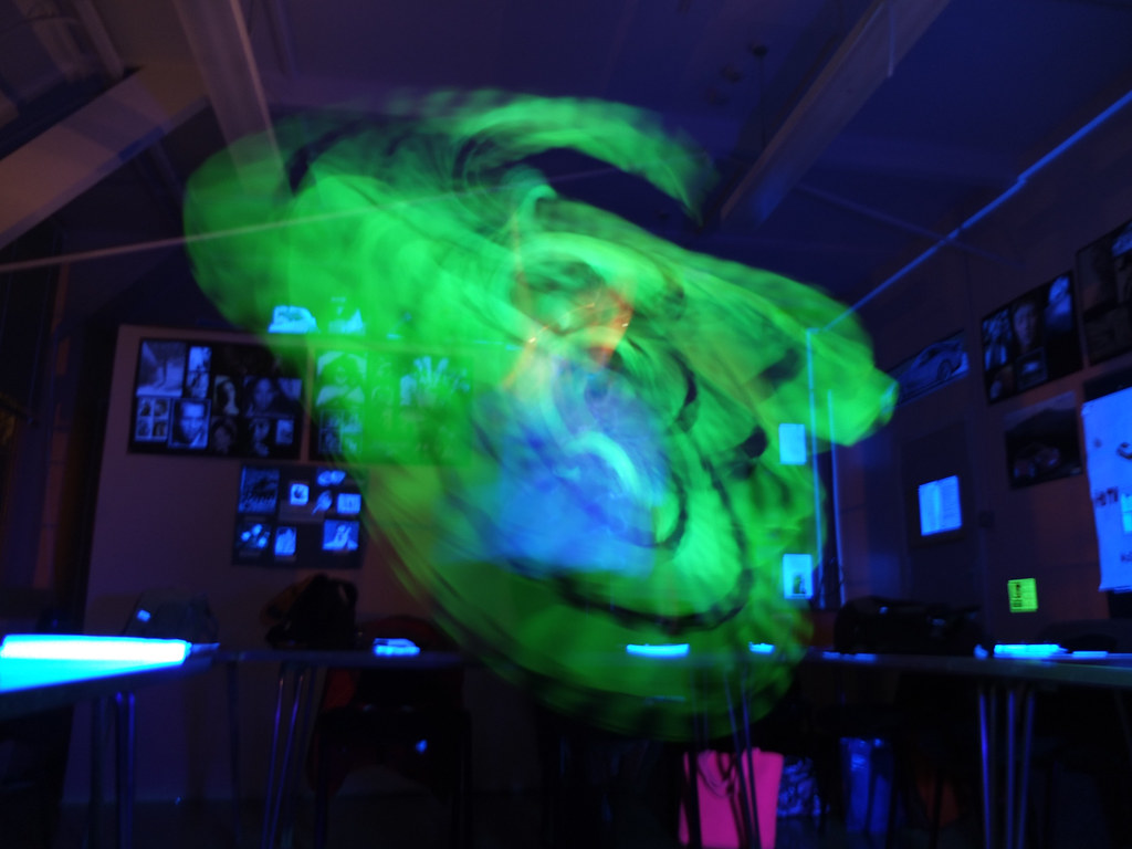

Souldeep - that looks like a fun session!
Last year I ran a light painting workshop for my local camera club.
http://www.wild-landscapes.co.uk/Bl...ssion/16337521_ck7HDf#!i=1228133953&k=nxCWzvK
That was organised in a hurry. Got another one coming up after Christmas with a different club and I plan to be quite a bit more ambitious :)
Of course, Duncan, that's it - didn't bother to look at the data! Ties in with the fact I was using the Slow Synchro by accident, and had a standard lamp immediately behind me. I'll ring Fuji to cancel the priest!

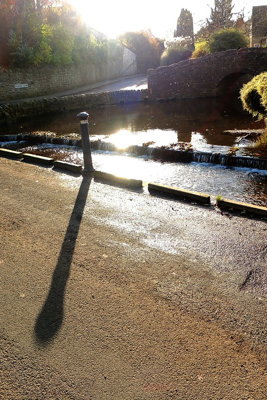

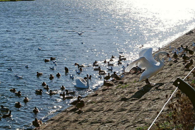

Clearly visible on the second water shot (this one: "DSCF9373 by peter_garbutt, on Flickr").
Or am I seeing something that's just not there?
I can't see anything at all
Click the image and select the largest size on the Flickr site. There are well-defined specular highlights visible (reflections from the water). I'm just not sure this is normal or not; it is a rather testing situation...

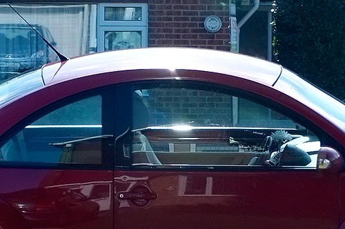

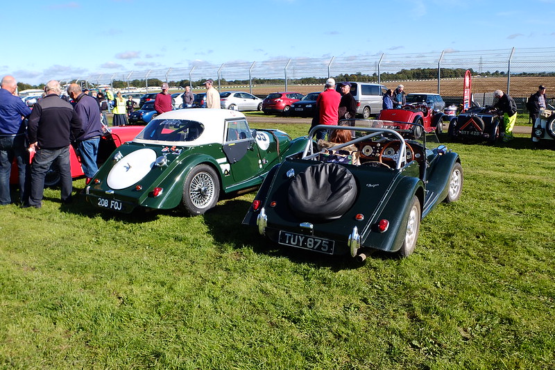

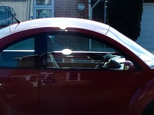

Pete, the highlights on the cars look similar to orbs, but the edges are not so strongly delineated, they seem a little softer. You are going to get "disc blooming" to some extent on any digital camera and of course it depends on your settings.
I would be interested to know how the latest camera performs.
I took some before and after shots with my X10 of sunlight induced highlights on my car and the after shots were a huge improvement.

Morning, Pete. The photo of the cars as well as the water shot show well-define specular highlights. However, the cloister shot is, to my eye, at least, orb free. Yes, there are over-exposed areas (the lights in the floor), but they are not characterized by the typical crisp, clear, hard-edged circular white spots.
I would certainly contact Fuji again and point the problems out. And like Allan said, this might be a one-off aberration. In fact, your report is the very first one that I've come across with the this issue.

The water shots most certainly show many Orbs.
The car shot shows many characteristics of orbs but they are broken by ray flares rather than a hard edge.
The cloister lights show the square shape of the fitting away from you and round spill on the fronts, But is has quite an unexpectedly hard edge in front, much like an orb.
This is different to any thing I have seen from my new sensor, which is normal in the way it treats spectral highlights.
Your sensor seems to show characteristics of both the old and new sensor, in a way that is very confusing.

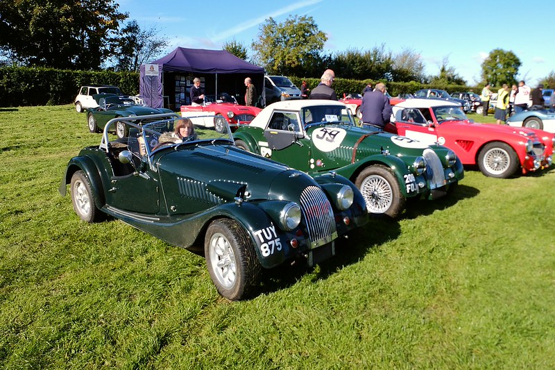

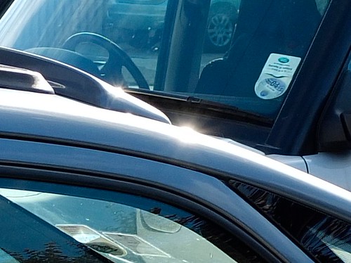

What do you make of this one, Terry? (No focus problem apparent like the first - I haven't checked the data - probably stopped down, and using a slightly longer focal length which reduced the problem considerably.)
I shouldn't lead you really, but have a look around the wheel arch of the Morgan +4 Supersport, (FOJ on the left), and odd cars in the backgound:
DSCF9123 by wylyeangler, on Flickr
At this magnification, the effects, such as they are, are by no means intrusive - but on cropping and enlarging, things can start to look odd.
Anyway, Fuji may or maynot have changed the sensor since this - they only own up to changing the lens last time (which is strange since they said the focus problem was caused by the new sensor being out of alignment).
I'll report back if I discover anything today in this wonderful sun.
Pete
Hi Pete
The large spectral highlight on on the rear wing of 208FOJ is as I would expect it to be.
The one on the rear wing on the blue car above "Almost" looks like an Orb...
But I think the extreme brightness of the low sun at this time of the year is likely to give that appearance on any digital camera. and is very easy to sort in PS if it catches the eye.
I think it would be more interesting to see what happens on windy water in bright sunlight.. (very small spectral highlights are likely to be resolved as circles anyway.)
There is fall off in focus on the left side of the photo. In the centre and right of the picture focus extends from front to back. On the left it is not sharp anywhere.
Terry

Agreed about that big reflection, but what about the curious little ones above it on, and adjacent, to the wing? Fuji identified one on a Mini, far away in the backgound, but I had trouble finding the car, let alone seeing the 'orb'!

PS The focus not good on this as you point out, but much better than the first - thank goodness that aberration, focus or otherwise has been fixed.

My golly it's bit fresh out there today, isn't it? I've nipped back to the cottage for a bit of a warm-up before 'orb-hunting' again.

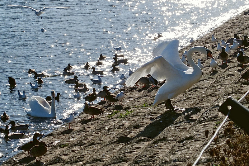

I thought I'd post this to be going on with:
Copy of DSCF9566 by wylyeangler, on Flickr
I think that this is about OK uncropped for small prints, but what about if I wanted to really emphasize that one-legged gull we see occasionally around here (only realised he was about when I saw him just now on the monitor)?. Cropped, the water around the ducks looks distinctly odd to my eye, although I must say I'm losing my ability to discriminate!
Copy of DSCF9566 cropped by wylyeangler, on Flickr
What do you think Terry (or anyone else)?
Pete
Pete
You know... I am coming to believe that we see some orbs because the X10 has such extraordinarily good flare resistance. In most cameras what we see as an orb would be flaired out of existance .
Very few of the "orb likes" have hard darker edges. But any hard edge aquires an outline with further sharpening.
If that is the worst you are likely to see in these extremely harh lighting conditions I would be very please with it.

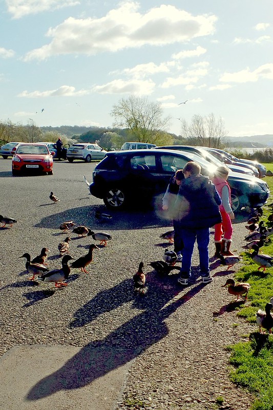

Hello Terry,
Just now, I popped down to the ford at the bottom of the road to capture more orbs. I can't believe the performance of the lens under these circumstances. The shot below is taken with the sun at so low an angle, that the whopping highlight midstream is the sun itself. There is very little flare caused by internal reflection, and, as you say, the sensor isn't swamped. Who needs a lens hood for the X10? I just have a UV filter permanently screwed in.
I can't see any obvious orbs here myself, but I think there is too much 'shatter' on the water's surface to produce other than tiny 'spheres' that the eye interprets as 'sparkle'. I think it might be surfaces of lower curvature, such as a more 'oily' ripple, or car bodywork that scatter the light less, that result in the phenomenon.
Copy of DSCF9597 by wylyeangler, on Flickr
At a particular magnification in this photo, I can see a sort of criss-cross texture especially in the top half (not the pixels which are smaller, and I don't think it's down to interference with the monitor screen): do you suppose this could represent the elements of the sensor being internally reflected because of the almost direct sun?
Pete
Ps There is one car shot I took today I'd like you to see later if you can bear it! I'd like to think I had an X10 as good as anyone else, then I could get on with learning how to use it!

Hey Pete... I'm just back from a day taking advantage of the lovely light mother nature shared with us today - New Forest - trying to capture some of the spirit of Autumn :D
Anyhow... what I was going to suggest with this piccy - if you had of exposed for the highlights you would have got a nice crisp reflection in the water (and a clear flair in the sky). It's the Duncan mantra :naughty:
Regarding the other photos, they are orb'ish and I'm surprised. I took some photos with water and reflections today as well so I'll check through my shots when I get a chance.
Hope everyone had the opportunity to get out and grab some other Autumn shots rather than orb hunting in the rare moment we got some good light :thumbs:
Hello Allan,
Thanks for posting those photos again - I hadn't seen them. I started reading when I came across this thread when it was on P.108, and haven't had the stamina to read all the previous posts.
You've almost put my mind at rest with those photos - almost. The shot below was taken rather in desperation today, trying to a get a 'subject car' just right. I think the reflections on most of the vehicles are like those on your X100 and X10 with the new sensor. However, as Terry mentioned, my sensor seems to be a bit of a hybrid and flatters to deceive. Look at the 'blob' - I won't call it more - on the red Ford arriving on the left of shot.
I hope you managed to keep warm in that cold wind. The New Forest must be looking lovely in the autumn tints.
The shot was taken only as an attempt to gather orbs, with no artisitic intent. But you are right - from my earliest years with the old Weston Master 11 exposure meter, I nearly always exposed for the shade, and do it now out of the habit gained then. I certainly did here, in spite of Duncan's exhortations (I have read and noted them) to do the opposite - it just goes so much against the grain! I'll learn (I hope!).
I'll be very, very interested in those shots of water of yours, if the conditions were similar to mine today.

On the contrary, we are here to help.
I see what you mean about the red car, but the highlight has light flares coming off it, so it isnt showing the normal characteristics of an orb.
Just out of interest, what setting was the camera on? There seems to be a lot of noise in the shadows as if you had a very high iso setting. High iso increases the sensor gain making it more sensitive to light. You are more likely to burn out the highlights on a sunny day
Allan
Allan
I also notice the clouds are really burnt out - almost like they have had PP applied. This doesn't happen to me in the same manner on my X10. Strange.
I would be surprised if this in Auto mode - and just wouldn't believe its in EXR (which coincidentally I have now decided to bury and wish it rip).
Pete
It was nippy - and I was wearing my wife beater! Not the most sensible of fellas me :bang:
The New Forest was nice - but due to lack of sun late summer has meant that leaves are dropping faster than they can turn to autumnal colours. Still a day spent in nature, with sunshine, always raises one's spirit :love: Also had a moment with one of the wild ponies in the New Forest that spun me out a bit. I was talking to the pony whilst looking through the view finder trying to calm him and get closer for a better shot, he looked at me like you're mad chatting to a pony - and I swear - he laughed! Mr Ed moment or what. Can't wait to see it once they are copied from the camera.
Will fast track them then - working on Korea at the moment, then Japan, but will sort today's outing as a priority.
Sorry, Souldeep, I posted the wrong image - it HAD had PP applied - here's the 'unmucked about with' original, again taken with intention of confirming the absence of orbs, and, I think, actually exposing for the highlights a la Duncan - I do listen at times! ISO 100. Obviously would need PP if the photo were important.
Allan
Thanks Allan,
Actually, I mucked a copy of the original about in PP, then posted it by mistake.
I equate low ISO with slow film and fine grain, which to me is the equivalent of low noise. (Ilford FP4 was ISO 100 I think, and before it FP3 ISO 64 if my memory serves me. At times, I used to love using PanF, ultra fine grain - ISO 32 or less, had very poor latitude - DR now I think - and tended to be contrasty, often needing correction in the darkroom at the printing stage). Using these analogies, I therefore try to use as low an ISO as I can get away with, bearing in mind the demands of exposure and whatever parameters bear on that, and set the DR to suit the contrast visible in the subject. Is that valid in general, leaving special effects aside?
