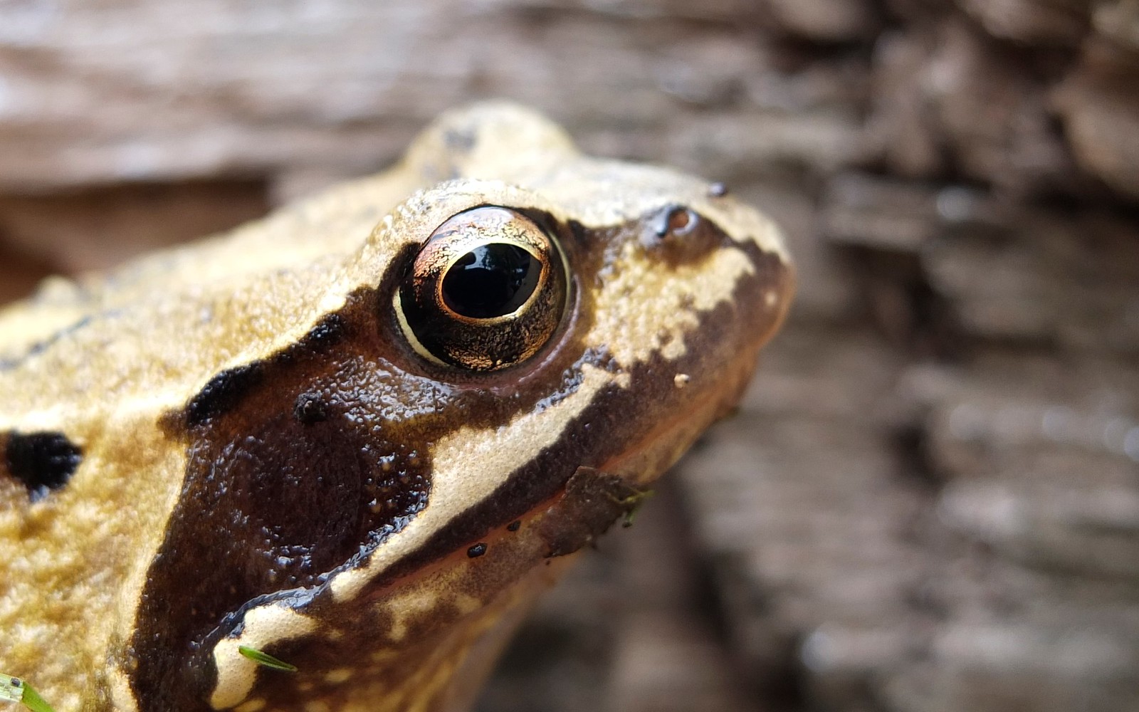

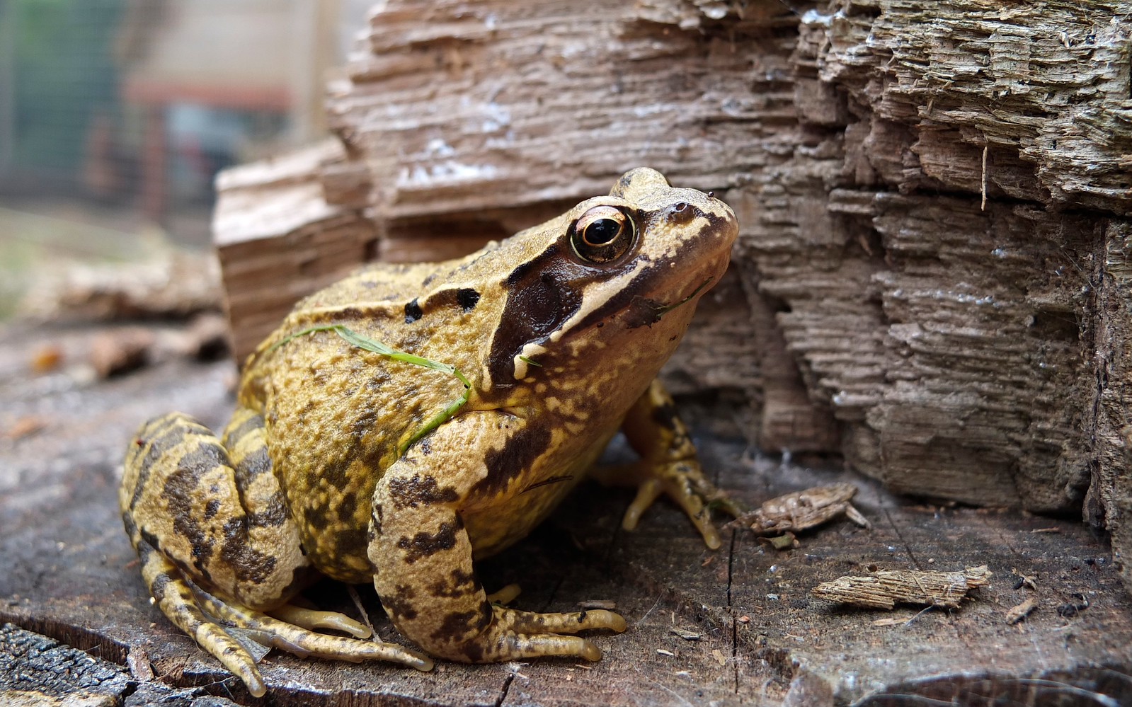

I needed to go out and reduce our woodpile and found this chap when I cleared around the chopping block.
These are jpegs straight out of the camera.
Allan
Nice
Handsome chap... keeps the slugs down too.
I take it that the lens was wide open as there is a fair amount of selective focus. The combination of a larger than normal sensor and a wide aperture make the X10 much more useful than most "pocket" cameras, with a very "film like" result.
The lens was at ƒ2.5. It was quite dull down there and I wanted a low iso and to isolate the subject from the background a bit. I probably could have got away with ƒ2.8 but I quite like the shallow DOF, especially on the eye.
I was itching to pick that bit of grass off too, but he would just have jumped away.
